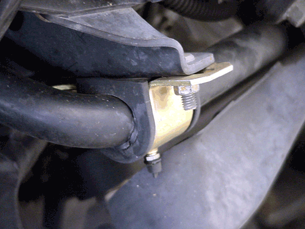

i bet its either a loose somethign moving around or a bad strut..sway bar wouldnt do this...it really doesnt move much if at all during a speedbump manuever, it only will really get working when you compress one side and not the other...it will move a lil on speed bumps but it will move evenly on both sides..and rotate in the mounts. and this wouldnt create a clunk...
yes a swaybar bushing would do this.. its a very common problem on the ion's
