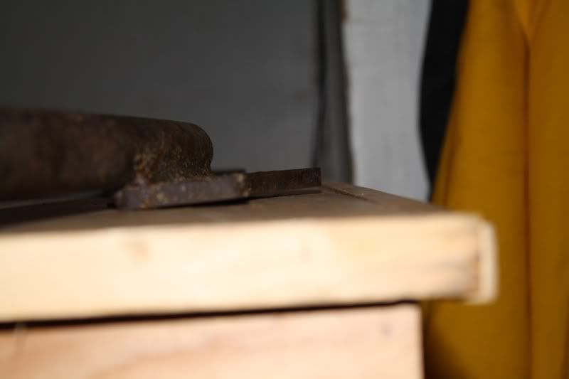

so what should i be looking for? to decide how messed up it really is?
When I finished unbolting one side it dropped down almost 2.5 inches. then I tried to push it back into position to touch the bottom of the spring perch and I couldn't I got it to within 1" of the bottom of the spring seat then I wasn't strong enough to move it anymore... would that be putting a slight preload to one side?

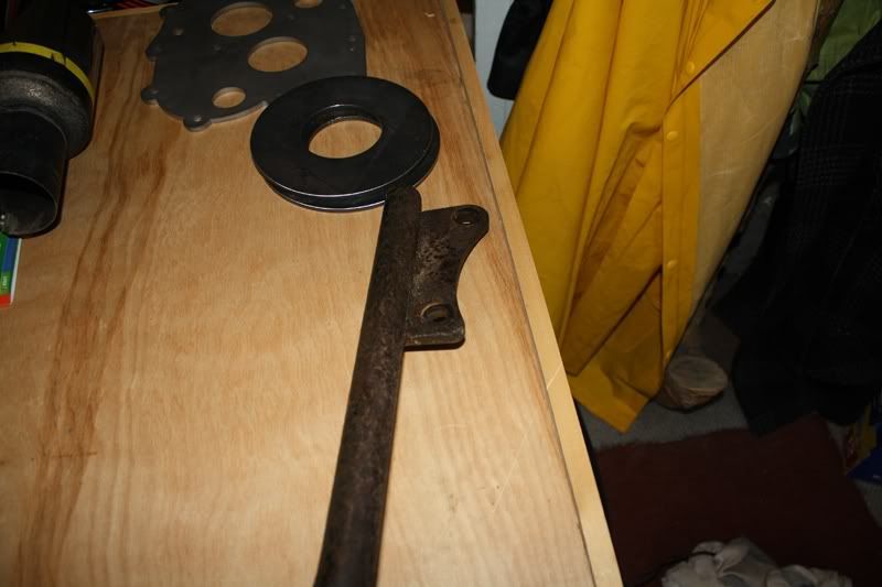

a few other pictures of there awesoem powdercoating:

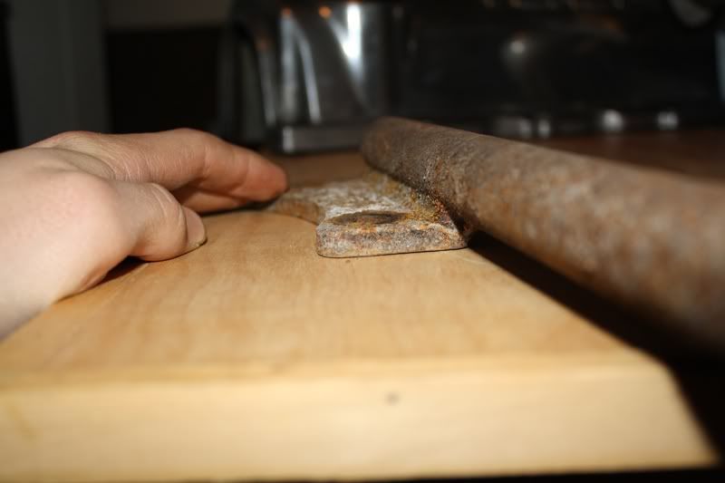

and I noticed this: to get that bracket to sit flat the other side of the sway bar is about 6-7 inches off the table.

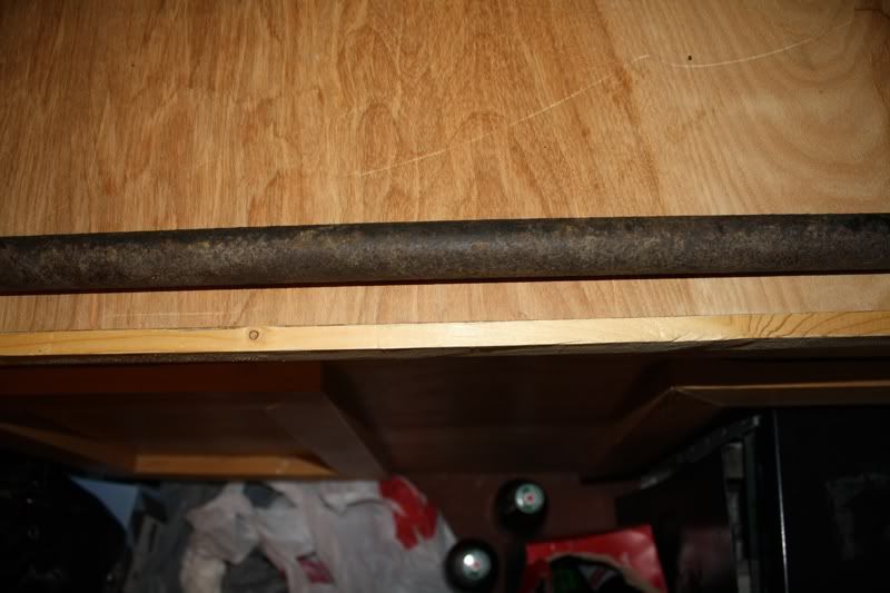

4inches out. had my woman help so it was accurate.
sitting flat on the table:
the other side:
That is why they are so cheap!
