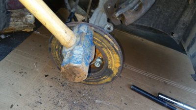

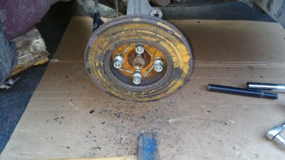

    If you are interested in getting wheel bearings off (Hub and all)
    look here. Take and old disc/rotor from your car or one that fits and
    put it on backwards. Put some big washers on studs.
    Put lug nuts back on. I used some eye hooks as didn't have any
    washers big enough to fit studs. Make sure lug nuts are tight.
    Hit the disc/rotor with a 12 pond sledge hammer.
    There you have it. I call it the "Hub Bearing Assembly Buster"

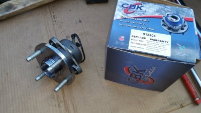

    The CBK Hub Bearing Assembly units have been good so far 2 months of
    driving, no problems. They have SKF bearings in them.
    I will use them again for $90 CAD
    If you don't have ABS you can easily take the ABS off
    of the assembly. So either assembly can be used if no stock.
    See pics if they are still up.
    Thanks
    Switchbacker
