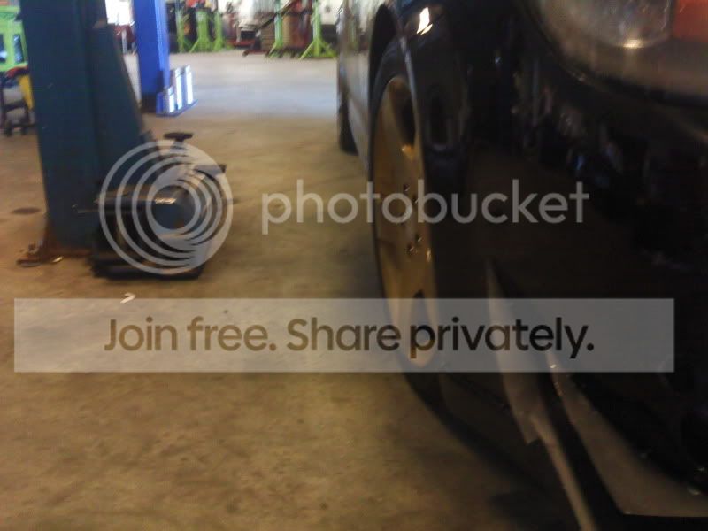

i'm still not crazy low, but low enough to compliment the wheels. I am on ground force front springs and "trimmed" rear progress springs.

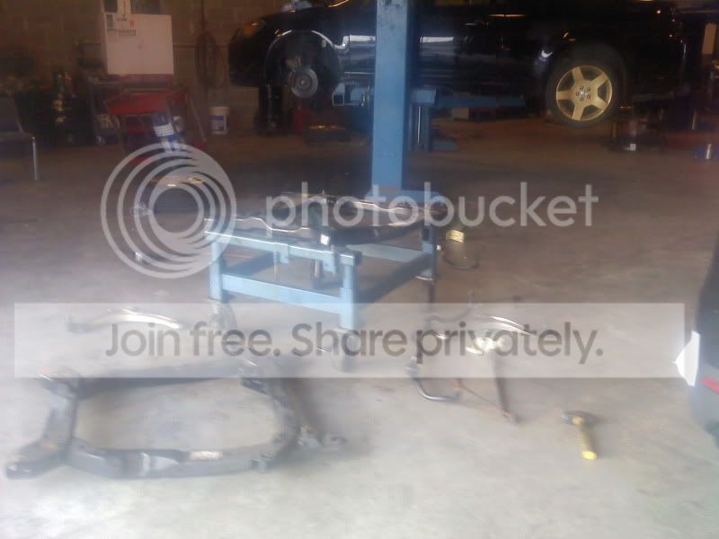

so the story is...hit a curb.
positive camber </3
replaced the cradle, struts, control arm, knuckle, hub and prepped my wheels.

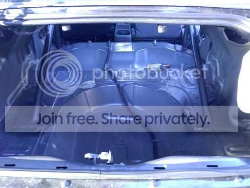

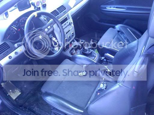

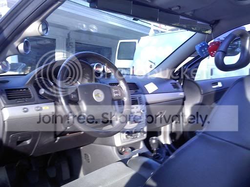

still got my half finished roll cage and rci harness, wink mirror, knockoff grant wheel.
needs wheel spacers. i am planning on using 25mm rear, possibly 30, and 10mm front possibly 15.

for the interior, gotta finish up the custom roll cage and line the whole car with bamboo flooring and zebra carpet. budget build at it's best lol. enjoy!

stock recaros
6 point cage
rci 4 point harness
wink 5 panel mirror
autometer pro comp: oil press, water temp (intercooler temp), boost/vac
aem uego
aeroforce interceptor
