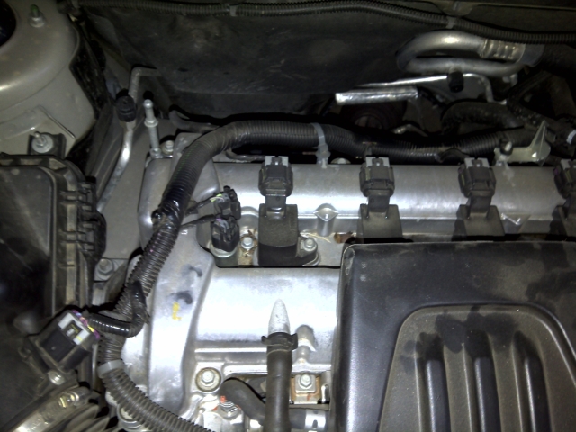

I'm getting a P0102 code on my 2009 Cobalt LT - It seems to have started when I removed the plastic shrouding on the engine to take a peek at what's under there - I had had a problem with the car when it was in warranty and the dealer said it was showing 'very lean mixture' on his computer (my obdII scanner didn't show anything) - they supposedly fixed a vacuum hose that wasn't seated, and it was fine for about a month. Now I'm actually getting an engine light and a P0102 error, which is a MAF Sensor error. Where is this MAF thing? I took a photo (attached) of the engine, if someone could point me to the part I need to be removing/replacing - Thanks!

you MAF is on your intake. if you look at where your filter is and follow the plastic up a little bit to those wires coming out the intake, that is it. you will need a small allen key to take it out tho

OK, I found it - I'm thinking that something happened when I took off the plastic shrouding, because that's when it began to show errors. Today I removed the MAF sensor from the air intake, blew it out (probably didn't do anything, but what the heck) and plugged it back in - removed the electrical tape from the wires and checked them for breaks but nothing there. I really thought that it was a mechanical problem (bad plug, broken wire, etc) but don't see anything that could cause a problem. I guess if the code comes back when I drive car tomorrow, I'll just have to buy a new MAF sensor and see if that's the problem, although I really don't feel too good about that - I still think it's something to do with the harness, but don't know any way to check that.
