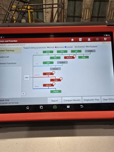

Going into the RCDLR with the scanner, I have a C0569(which i can not get to clear)
Checked fuses (recommendations from other posts) and they are good & not corroded. Tried writing sensors to the car and scanner says complete but no pressures show on guage and still error message & tpms light (also tried on my autel tpms tool).
Complete code history

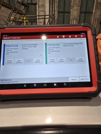

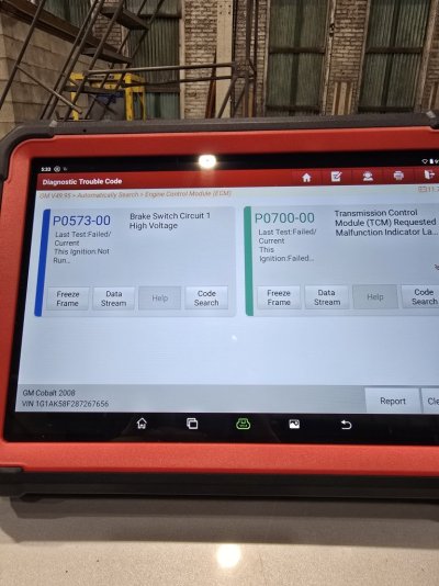

Ecm- P0573 & P0700
Tcm- P0573 & P0705
Ecbm- C0561-71
Rcdlr- C0569
All codes will clear but C0569 stays(trying to.knock them all out as I go along)
