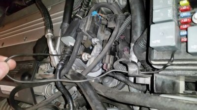

Sorry they been killing me at work. From what I can tell the main ground wires look good on the car. I'm not getting my ground signal to the relay to make it fire. The diagram I found said that the ECM has one wire going to it and the park neutral switch is the other. Does any know which one is the ground. Also jumping the relay out the car turns over but won't crank even with startung fluid. Haven't checked for fire yet but will be soon.
