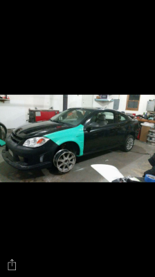

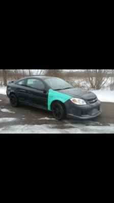

I have a 2010 cobalt 2.2 I am building it completely aftermarket. My question is can I run a 2006 2.0 cobalt supercharger on my 2010 2.2. I have the zzp exhaust manifold the supercharger throttle body and fuel rail with injectors off a 2006 cobalt will that run my 2.2
Yes, the supercharger setup will work on the 2.2L. Obviously it'll need tuning, but other than that everything is a plug and play affair.
