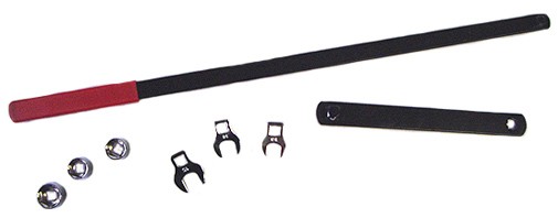

jack and jack stands
serpentine belt tool
air tools(electrical impact works fine too)

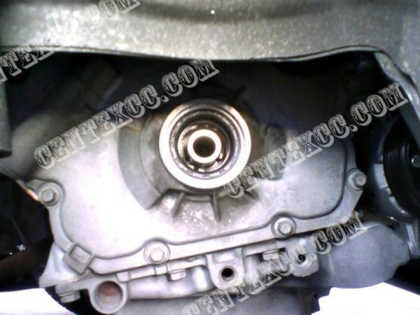

step 5: once the bolt is out you can wiggle the stock balancer out, i had a harmonic balancer removel tool with me, didnt need it, the stock one came out by wiggling it out, this is what you will see once its out

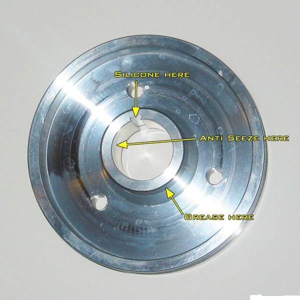

step 6: put silicone on the keyway on the inside of the pulley, you will know which im talking about when you see it, it looks like something slides in it, next put antisieze on the inside where the bolt will got thru, after that put some oil on the outer part of it to lube up the pulley for when it goes in, you can look at your stock one as it has oil on it too rom the engine
picture.php
where it says grease, put oil

No, the slot area it keeps referring to.
Just fixing a small problem in an otherwise flawless how-to.
