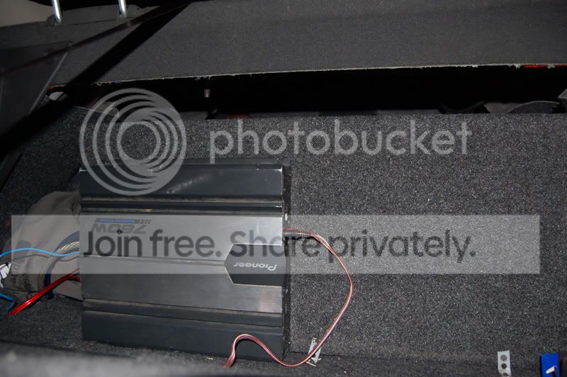

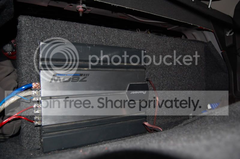

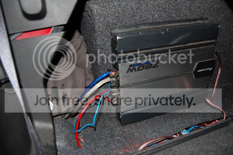

I'm getting a new amp because the one I've got in my car now BLEW!
[New amp comes next week]
I didnt install any of my current system [head unit, amp, subs, nothing!]
So how can I replace this amp?
And should I mount it [if I am able to] somewhere different than on the back of the box?

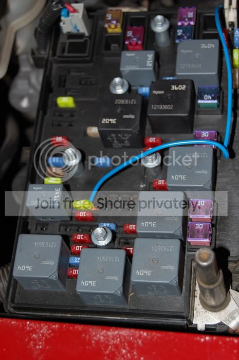

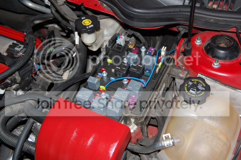

And please tell me why they ran this wire to the fuse box. Ive heard that youre supposed to run it to the back of the head unit.
Thanks!

But to assist in answering your question, I would mount the new amp in the same place as the old one, the line that they ran to the fuse box is likely your ACC wire for the amp and is ran there so that the amp turns on and off with the car running instead of when the headunit is on (saves battery)

the wire to your fuse box is what tells the amp to power on/off. mine is located in fuse box that is inside the car not under the hood. it isnt a good idea to put it in a slot that already has a fuse in it. basically you have a power cable, ground cable, speakers cables, power on/off cable(not the correct name), rca cables. the power cable goes to the battery, make sure you have an inline fuse. the ground cable needs to be grounded, speaker cable go to your speakers(obviously), and rca comes from your head unit or line out converter however you are set up.

personally i would just replace the amp in the same spot because all the wires are already in place throughout the car and cut to a certain length. the one thing you can change is the remote (blue wire in fuse box)wire. a remote wire can be cut and extended unlike a power wire. i would run the remote wire to the head unit output. there should be a blue wire with a white strip on it that is your remote from your head unit. that way whenever you turn on ur head unit the amp turns on. if you are going to leave it in the fuse box then i would recomend raising the amp of the fuse 3-5amps.

first get a add a circuit for that blue wire going to the IGN fuse under the hood, look ghetto like that, sure it will work but looks ghetto...and just swap each cord on at a time with the new amp, would make things a lot of easier

if you are sitting in the passenger seat and look to the left at about the height of the cup holder there is a fuse box in there(there is in my car anyway). You can just run the remote line under the trim on the passenger side and hook into that fuse box. I will see if I can find any pics online.
