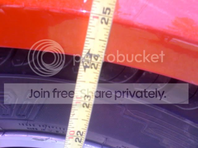

my sig is when i had my ksports on but not lowest as i have it now, ill go take a cell phone picture.... im tuckin tire all the way around with 24.25" from the fender to the ground.

that looks really nice. maybe some day i'll set it that low.
i just finished with the fronts today and have not measured yet but i will.
