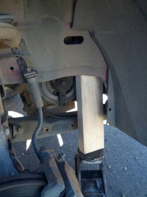

Not sure I'd anyone has had trouble reaching the tensioner release hole to remove an install your drive belt ,its almost impossible without loosening engine mounts but I found a video on YouTube about it using a jack an a block of wood works pretty good Lol just be careful how high u go with your jack so u don't break your tensioner , just replaced my alternator this morning

I borrowed my co workers SNAP ON one an i didn't work there is absolutely no clearance to fit one in there although there may be a special GM tool that fits without doing this. Anyways. I'm glad this way worked otherwise I would a been screwed good ol YouTube is a lifesaver some times lol

Hmmmm harbour freight hey? I think that's the one I needed its pretty low profile hey? The snap on. One didn't fit. However. The back yard way worked fine lol uploadfromtaptalk1380127614683.jpg

Lol. It works but u just have to be careful. , I only did it this way because I didint have access to the proper tool an I need my car road worthy by Friday because I will be traveling with it. For work, mabey just save yourself the trouble an order the tool before hand

I presume you had that propped against the tensioner? That's one way to get seriously injured, that 2x4 becomes a projectile real easy.
