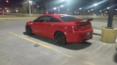

    First day away from the driveway. No leaks!
