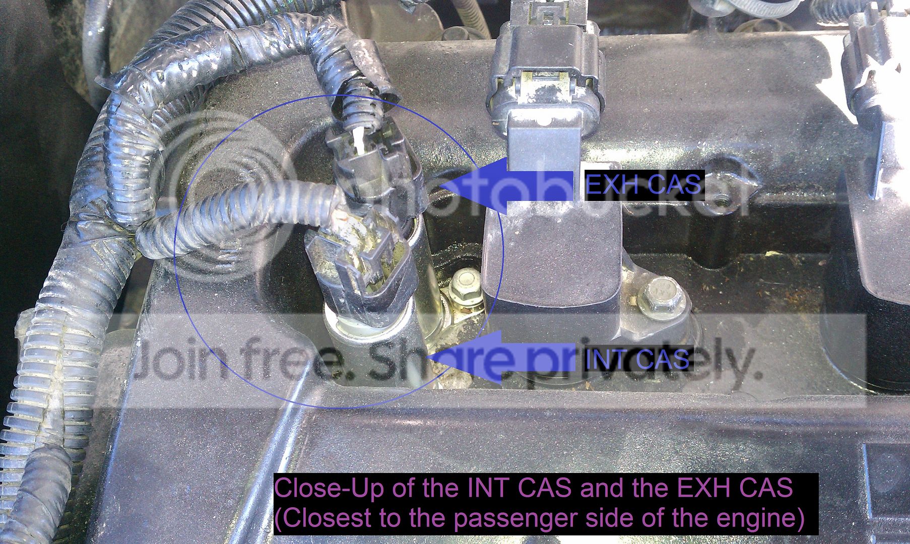

How many miles since your last oil change? If not recent do that and clear the code, if it comes back in a short amount of time you need to replace your exhaust camshaft actuator solenoid. More than likely with that mileage you just need to replace the solenoid.
GMPN: 12628348
getimage.php
Goes towards the back of the motor.
Single 10mm bolt and removing the connector, then just twist and pull up. Lube up the seals on the new one and drop it in. 10 minutes max.

I change my oil every 5000 miles I'm 1200 miles into my last oil change I cleared the code it hasn't came back yet, but I will take your advice and change it out.thanks so much for the pictures and part number.thanks!
