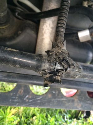

Hi all. Been searching for days trying to figure this out. Anyways I have a 2005 cobalt ls. The check engine light is on showing p0442. I'm figuring it is the vapor line coming off the evap canister as the t fitting is broken. I e had it taped up for a little while now but looking to actually fix it. Tried to get a decent picture of it. Where would I go to get this or how else would I go about fixing it? Thanks.

Check the catalog over at gmpartsdirect.com or visit a dealer. They'll know which part that is.

Ok. Thanks for the help. Actually I had emailed then and just never noticed until now. They said that these hoses aren't sold seperately. Only sold along with the actual fuel tank. Maybe I can just get some sort of t connector and hose adapters along with the hose clamps and fix it that way because my fuel tank is fine. Thanks for the suggestion.
