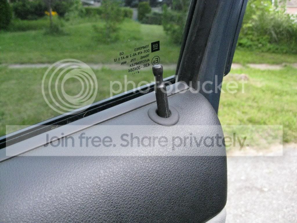

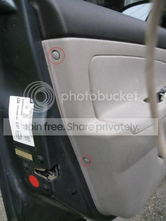

1. Start by using a Flathead screw driver and pushing down on this tab to gain access to the screw in the door.
2. Using your Phillips Screwdriver remove Screw.

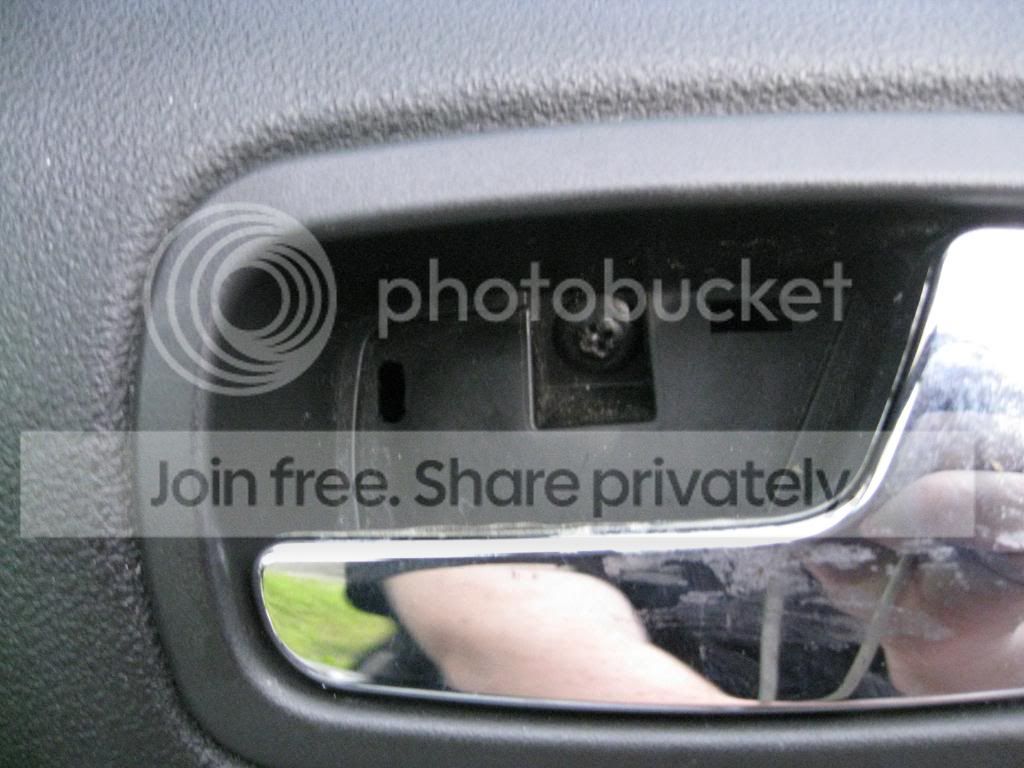

3. Using the Flathead again, pull tab out from Door-power window module. Remove two screws using Phillips.

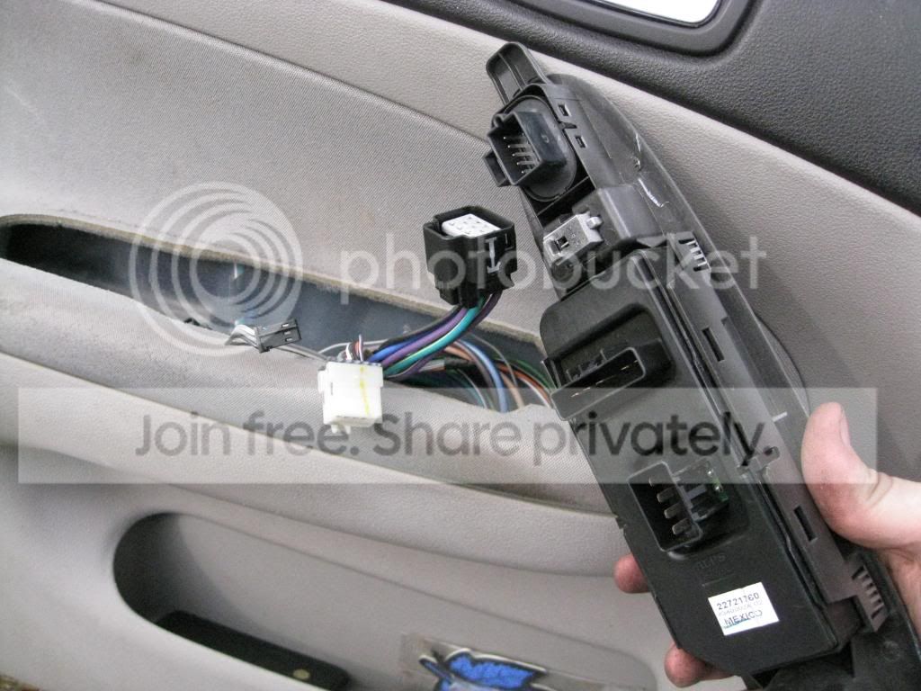

4.Pull up on Power window module, it should pop out, and remove the cables from it, they should all clip out, don't pull on them, use the flat head to remove them.

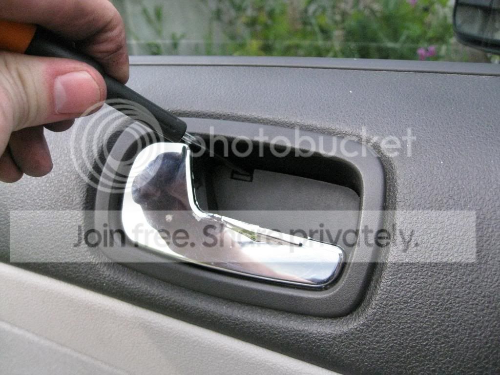

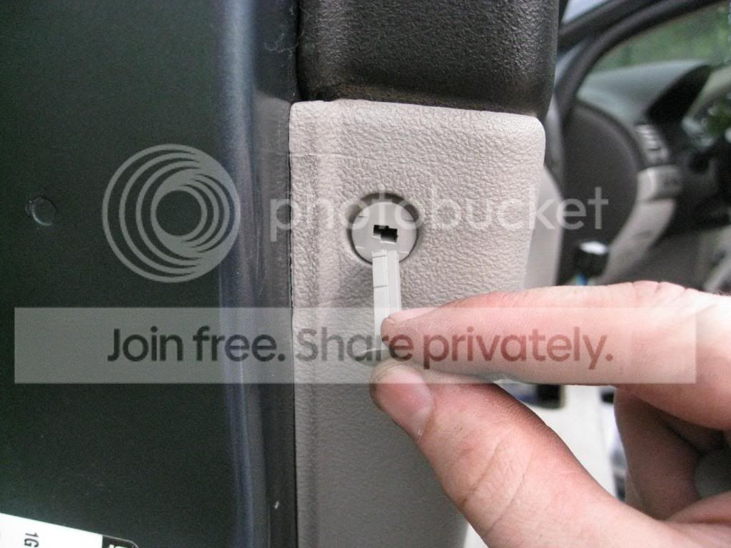

5. On the side of the door there are two grey clips, Use a flat head to pull them out.
6. You can pull these grey clips apart, they go back in no problem after, just re-insert them.

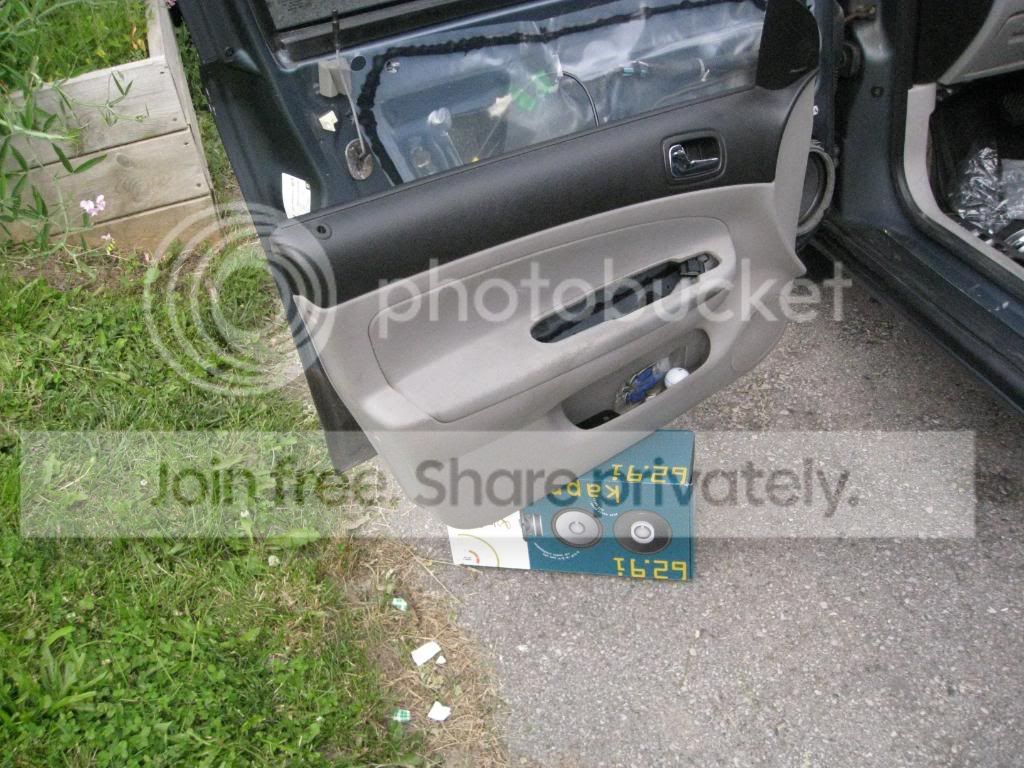

7. Pull firmly and straight out on the bottom of the door to unhinge the clips holding it in place, Next pull up on the top of the door to pull the door lock out properly. Just pull on the tweeter box to remove it. I placed it, on the box to rest if comfortably, as it will still be hanging by wires. Also helps move it out of the way.

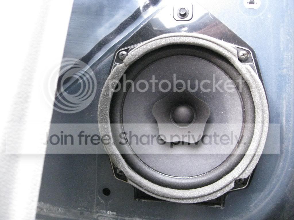

8. Using a Phillips Screwdriver remove the old speaker.

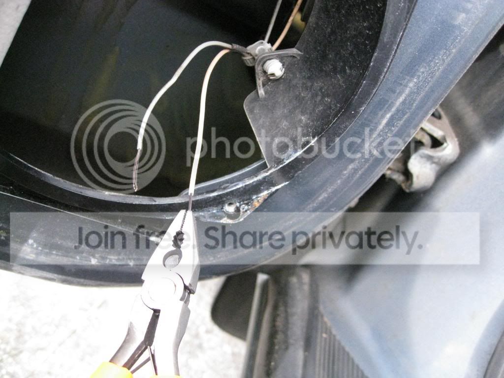

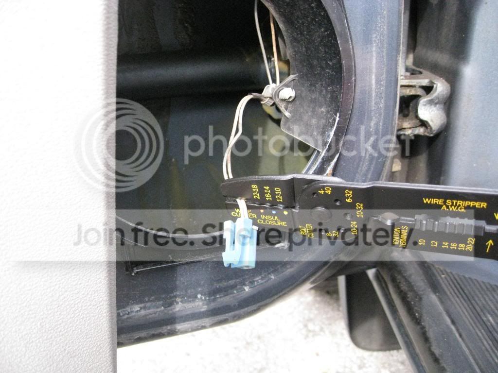

9.Un-clip the old speaker, cut this blue clip off, and strip the speaker. I recommend cutting close to the blue piece. There isn't much wire in the door.
10. Using pliers, twist the speaker wire for easier install.

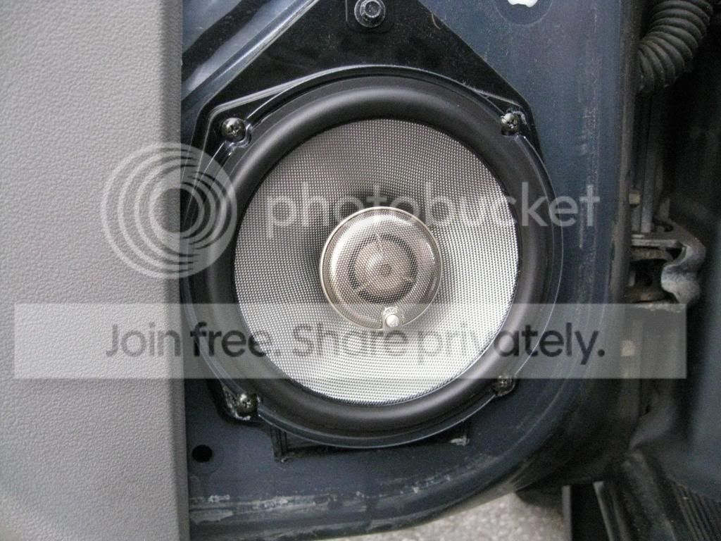

11. Install and re-screw new speaker. - If you have base system, you will have to create you're own holes for new speakers (What the self-taping screws/mounting tape would be for)
