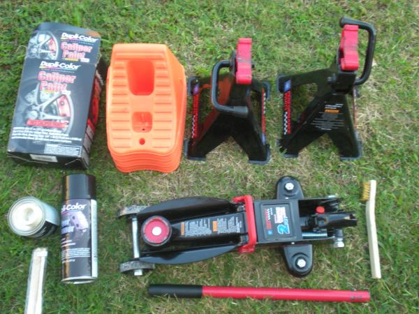

What you need:
Jack stands-x2 (x4 if you want to do all four at the same time)
Jack- note DO NOT DO ANYTHING IF YOU ARE USEING THE JACK TO SUPPORT THE CAR USE STANDS)
Duplicolor Caliper Kit- autozone,pepboys- 20 bucks
Chocks
flate unslanted spot to work
a toothbrush or equivalent
something to remove lug nuts
as pictured:

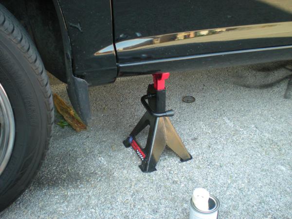

Step 1: Obviously it would be easier to work with if you had not previously been driving it as far as the brakes being hot. So if only doing the front place chocks on the rear wheels and engage the emergency brake.
Step 2: Jack the car up high enough to allow the wheels to come off clean. support the car on jack stands.

What you need:
Chocks
as pictured:
