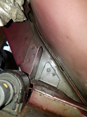

There are 2 problems. 1 is the weld nut at the top is
ceased. 2 the bushing is ceased around the bolt.
Because I had both problems I assume it is common.

Then use air hammer chisel and get at the cage over the weld nut.
Sharpen chisel before. Cut the cage off.You will need a mirror
to see the weld nut.You have to cut the cage blind.

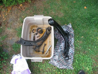

I had to remove the complete control arm before cutting through
the bushing and bolt then pushing the top part of the bolt through
the top and get it out. I had the cut the control arm apart around the
Bushing using stone age tactics drilling, chiseling and air hammering.
Was hours of labor. After I did this I was able to get all of the rubber
out of the way. Then I torched the bushing freeing the bolt from the bushing.
I was unable to get a wrench or a Vicegrips on the weld bolt because it
is rectangular. Torching the weld bolt is blind. The new bolt is Dealer only.

sure my tools made some bare metal up there. I bought the middle control
arm not the cheapest. It came with a new ball joint bolt. Everthing goes
back together easy. Took it for a test drive, perfect!
