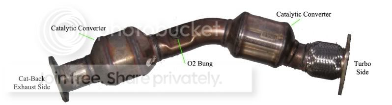

The downpipe is the portion of the exhaust that connects the turbo to the rest of the exhaust system (cat-back exhaust). On our cars the dowpipe comes from the factory with two Catalytic Converters on it (more on Catalytic Converters http://en.wikipedia.org/wiki/Catalytic_converter) their main purpose is to help reduce the emissions coming out of the tail pipe, because of this they do restrict the flow of exhaust gases and because were all about making more power that's a bad thing. The stock/factory downpipe is the most restrictive component in our exhaust system. Replacing the downpipe with an aftermarket unit will greatly improve the flow of exhaust gasses out of the engine and in turn help us make more power (I've heard anywhere from 10-15 horsepower and 10-15 ft/lbs of torque). Below is a picture of a stock downpipe from a 2008-2010 Cobalt SS Turbo

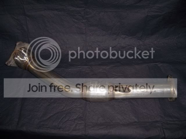

Catted Downpipe
An aftermarket catted downpipe may be purchased, these downpipes remove the (2) stock factory Catalytic Converters and replace them with one High Flowing unit, these downpipes also get rid of that little dimple you see by the O2 bung (which also reduces flow). If you have strict emissions laws in your state/province this is probably going to be your best bet as the high flowing catalytic converter helps you meet your emisions targets but flows significantly more than the stock cats do. These downpipes are louder and in my opinion better sounding than the factory exhaust and they do improve exhaust gas flow and in turn help us make more horsepower.

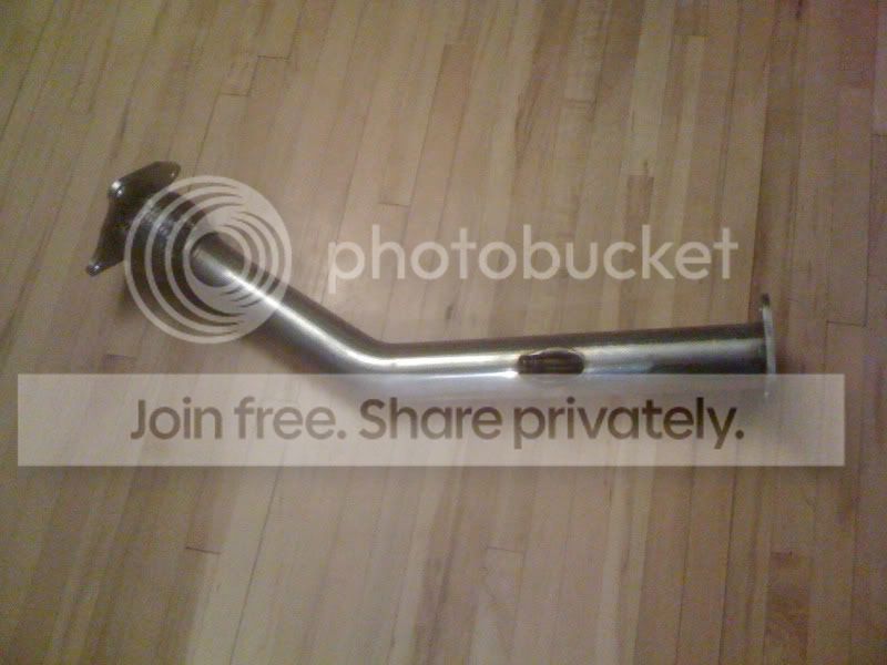

Catless Downpipe (commonly called Off-Road)
An aftermarket catless downpipe may be purchased, these downpipes remove the (2) stock factory Catalytic Converters and replace them with a straight mandrel bent 3" pipe they also remove the dimple you see by the O2 bung. If you don't have strict emissions laws in your state/province or your just a rebel this downpipe may be your best bet. These downpipes are a little louder than even the catted downpipe they provide more of a deeper gurgle type tone and yes they do improve exhaust gas flow and in turn help us make more horsepower, the catless downpipes can help us make an additional 1-3hp over an aftermarket catted downpipe because they have no cats at all.

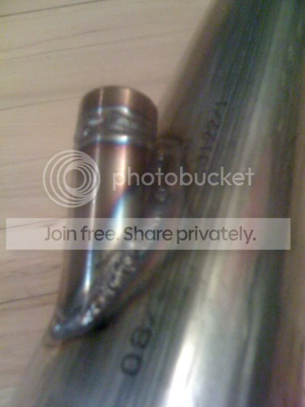

The O2 Bung/Chamber is the threaded hole where the Oxygen Sensor (O2 for short) sits. The design of it is important especially on a catless downpipe if the O2 sensor does not like what it's reading like when there is no Catalytic Converter infront of it it may trigger a Check Engine Light (CEL for short), which can be disabled via a code reader/clearer (can be picked up for relatively cheap) [if anyone has the link to the thread talking about CEL's for this please let me know]. If the thought of having to go get your CEL cleared scares you, you should probably just go the safe route and get a catted downpipe. Some vendors offer an angled O2 Bung/Chamber (usually for an extra cost $20-50) which limits the amount of exhaust gasses the O2 sensor sees this helps reduce the chances of getting a CEL especially with a catless downpipe I highly recommend getting the angled O2 chamber shown below:
