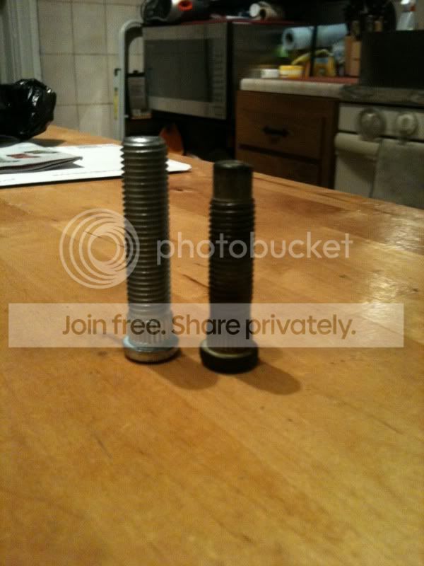

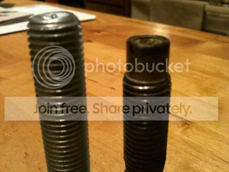

Here's the comparison

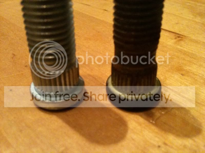

In this pic you see how much more thread the bolt on the left has than the stock bolt on the right. Exactly 1/2 inch more thread
Here is what the bottom looks like. When changing bolts, you should hammer in at least half of the vertical threads in to the hub before using an open end bolt to fully get them in. If you don't you'll strip the thread
