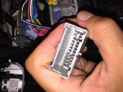

I have a 2006 Cobalt LT with the pioneer system in it. I wired up a harness for a new H/U that I am putting in. I matched the colors and what not, when I plug the harness into my car the interface chimes and everything works fine. The H/U won't power up at all, I checked every fuse and none were blown. I might be making a noob mistake but I'm not sure what I did wrong. Ps don't rip on me when you see the connections on the harness they are only temporary until I figure out the problem.

WestmorelandCam
Aug 5, 2015
7
I have no idea if you can see any problems with the crap pictures I took

You need to run your own ACC wire, the one in the harness won't work for aftermarket head units.

what harness? You need to attach an acc from the fuse to the pioneer harness. and it needs to not be connected to the red acc in the stock harness
