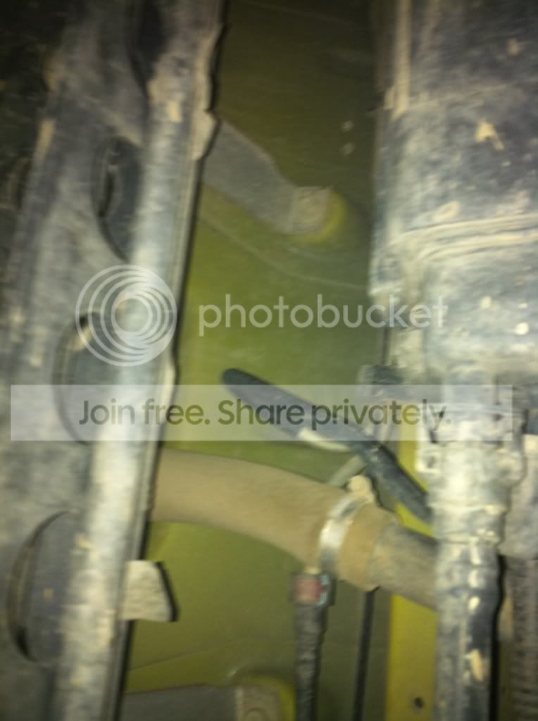

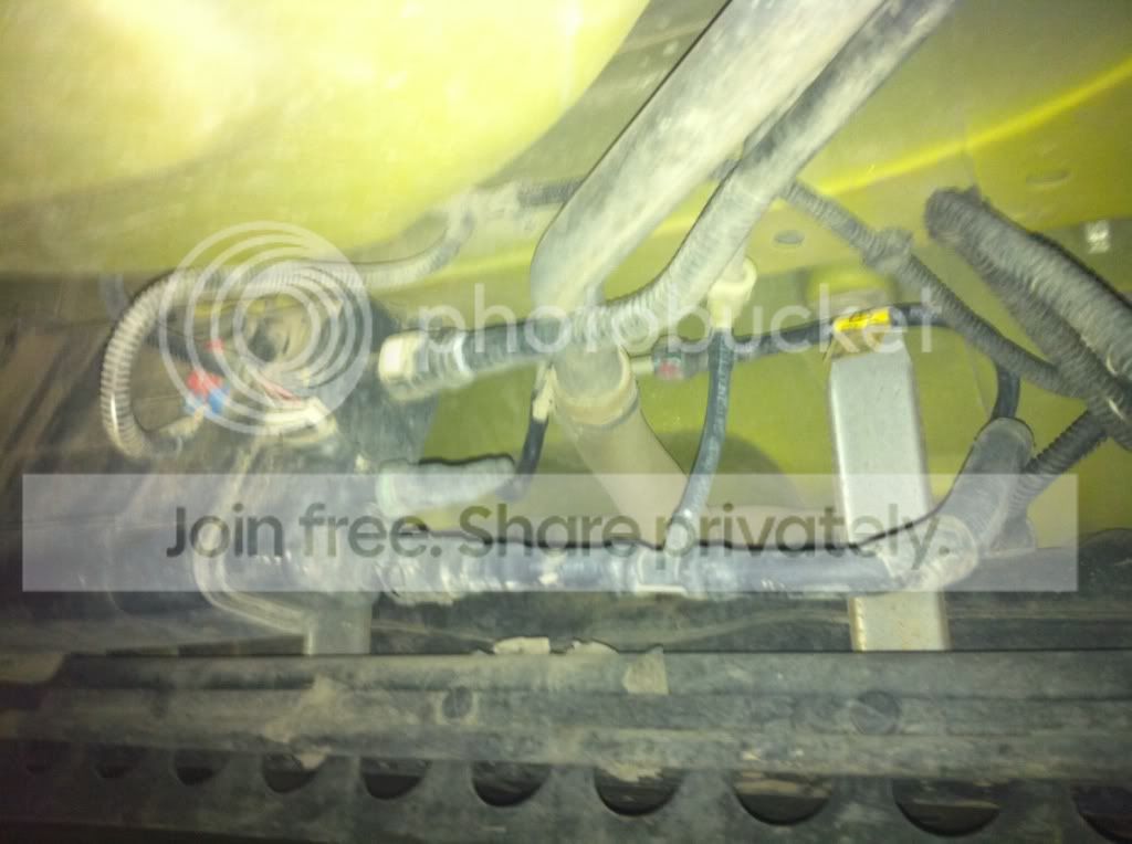

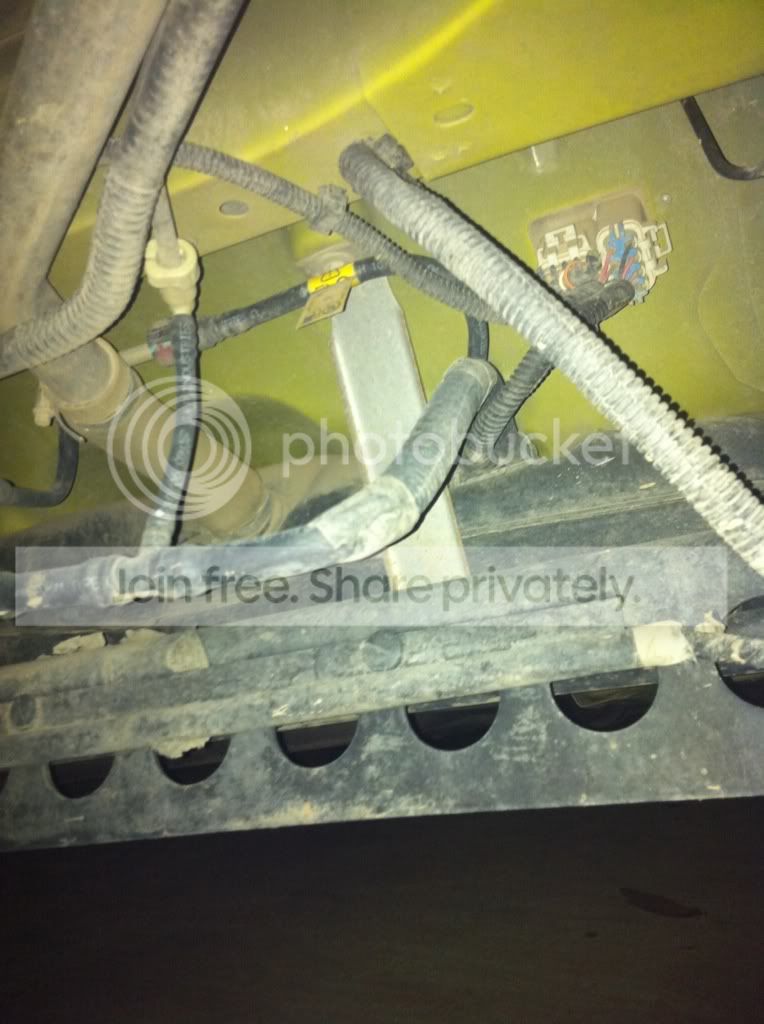

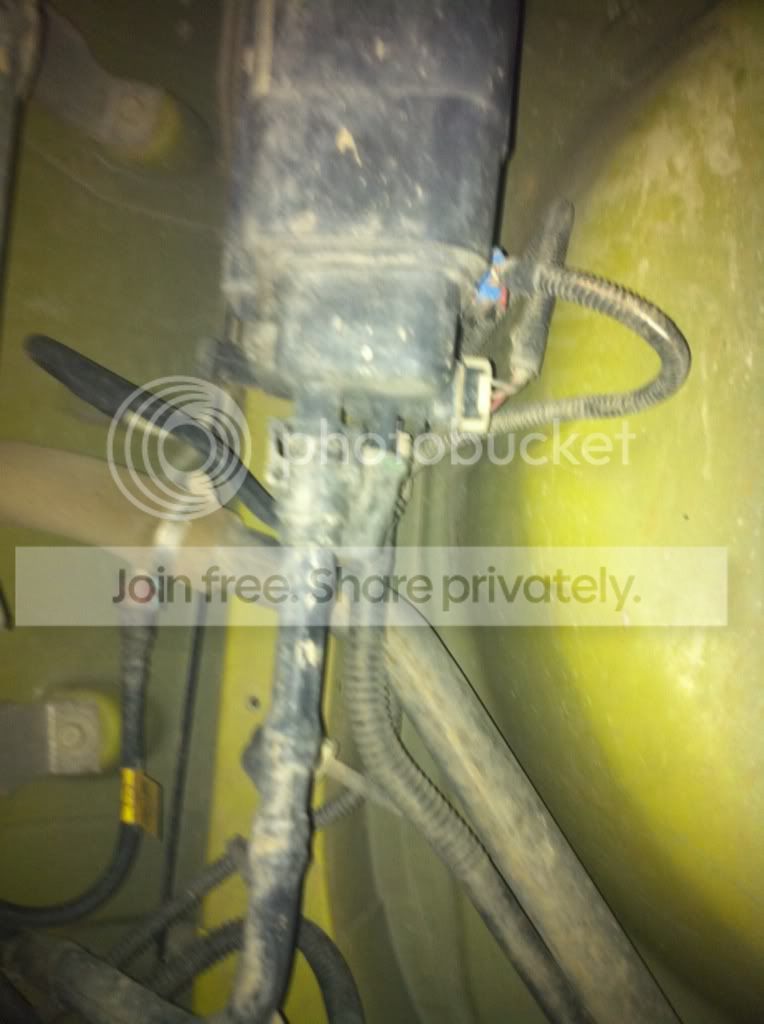

There is an external filter. It's near the EVAP canister.
Mr. Red Pony
Apr 20, 2011
55
Lawton, OK
Here.

Not all the 2007 and up have the external filter some have the filter in the tank on the fuel pump.
Mr. Red Pony
Apr 20, 2011
55
Lawton, OK
I know. Just proving mine doesn't have it. I will have to end up replacing the pump to change the filter. I hate in tank filters.
7,353
Wtf?!? Strange....So the only fuel filter you have is the sock on the end of the pump?
Mr. Red Pony
Apr 20, 2011
55
Lawton, OK
Not just the "sock" that hangs off the end. It also has on in the sending line right before if leaves the tank. Some pumps, you can rebuild and put a new filter on. But if you have the pump out. Just replace it. The car has 76k on it already so why not.
