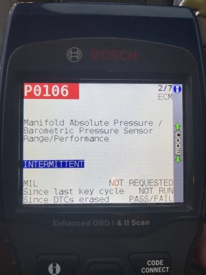

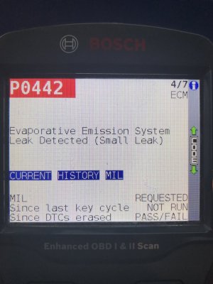

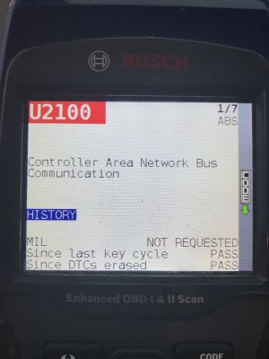

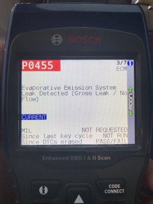

I have had a series of emissions related codes go off. The engine is having a fluctuating idle at deceleration and up to a sitting idle. I have replaced purge valve on top side of the motor and the valve on the gas tank. Was told to clean o2 sensor with electronic cleaner and that didn't do much. Every once in a while the check gas cap comes on and I have replaced with a cheap version from autozone and then purchase one from dealer. Still having issues.
