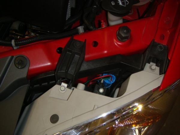

Step 1: Removing The Headlights
remove the 4 bolts holding the headlight and Headlight Bracket in, and then the light out, this is tricky; just play with it for a while. (10mm)
After you wiggle the light out of its place, simply unplug the light and set it to the side.

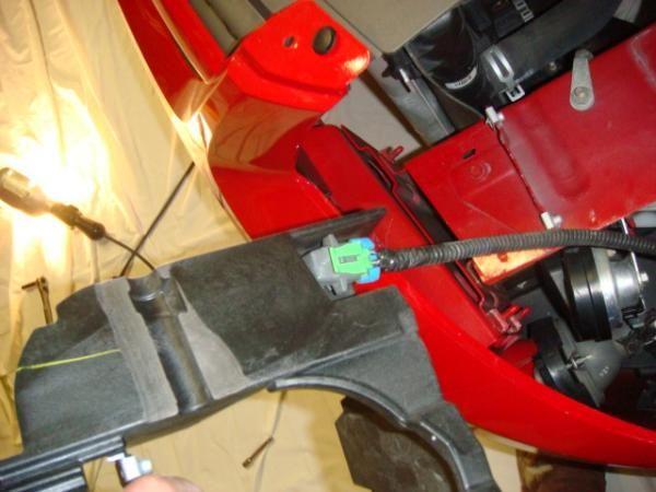

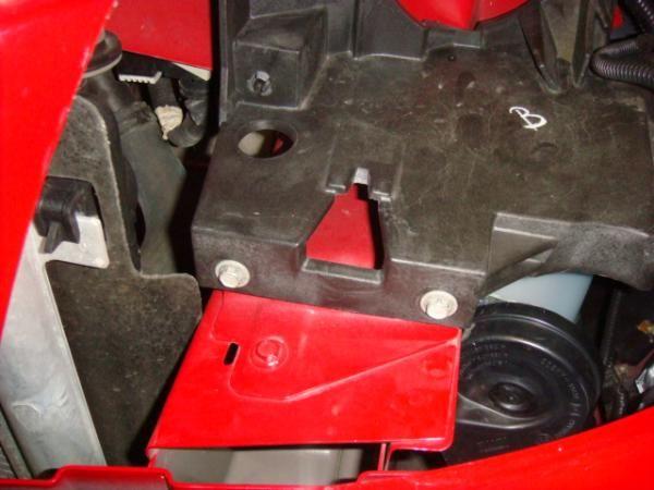

After you get the headlight out there will be 2 more bolts holding the headlight bracket in place; remove them (10mm).
When the bolts are out pull the bracket out of its place but be careful not to pull it out too far because there is a sensor hooked up to the bottom of it, i believe its the outside thermometer. Unplug it and set the bracket to the side with your headlight, and keep in mind this sensor is on the driver side only.

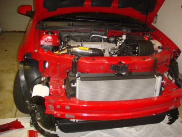

Step 2:removing the Bumper Cover
Jack the car up if you want to, this is not nessecary but it makes everything 100x easier and more comfortable.

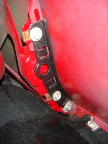

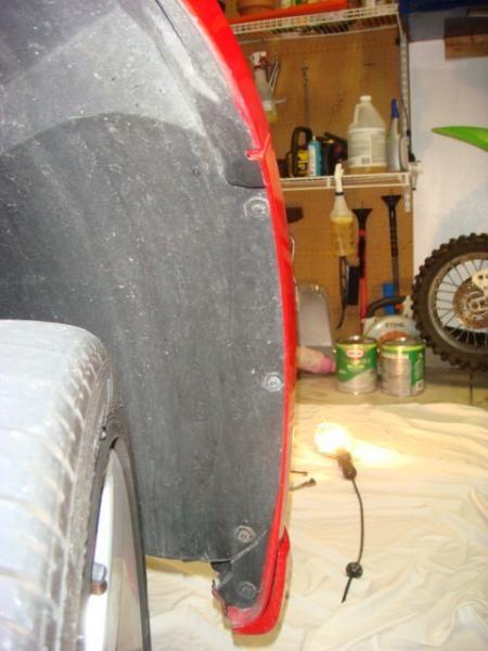

Remove the 4 bolts inside the wheel well (7mm) (you will need to turn the wheel all the)
There will also be 4 7mm bolts underneath the bumper too.
Repeat those 2 steps on the other side of the car.

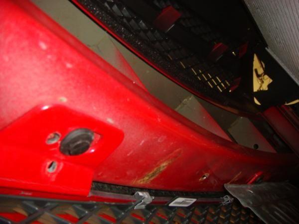

underneath the bumper there will be 2 push pins holding the bumper, pull both of these out.
Remove the 4 push pins that are holding your grille in using that flat head screwdriver
on both sides on the inside of the bumper where the headlights were, there are 3 bolts, the first 2 need to be loosend and the third one needs to be taken out completely.

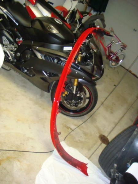

Your bumper cover should now be ready to be removed, so pull it off and set it on the blanket or sheet you brought outside.

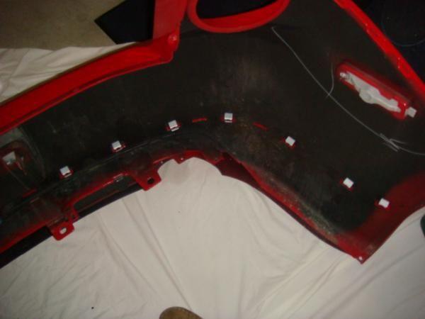

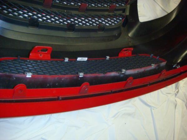

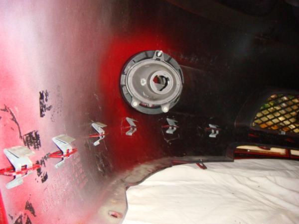

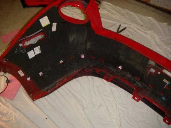

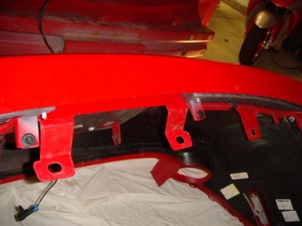

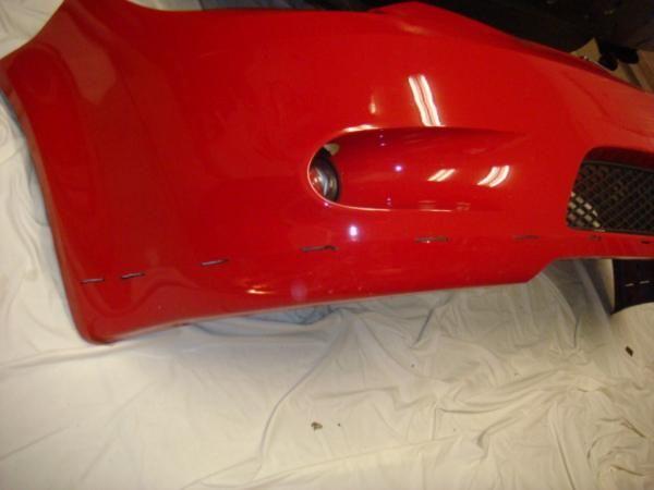

Take your dremel, and cut the slits that are factory marked on the inside of the bumper, i forgot to take a picture but they are very easy to find, when you are done your front bumper should look like this:

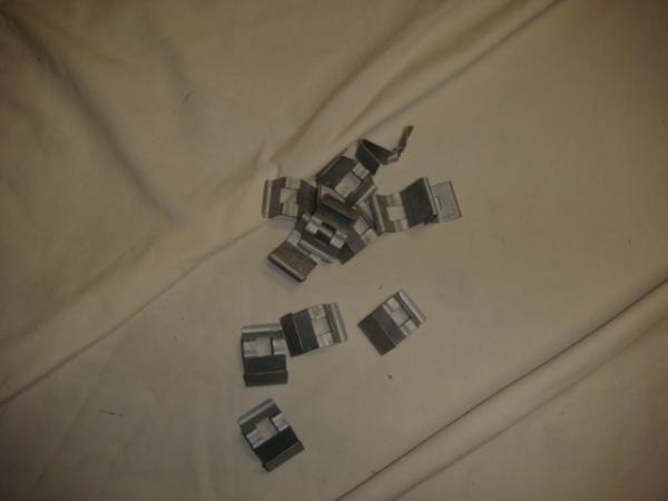

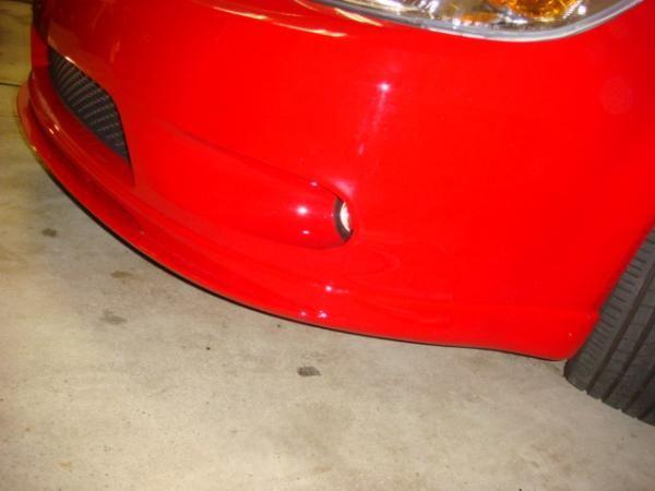

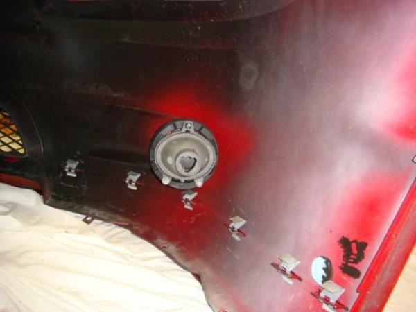

push the lip onto the bumper and count out 12 clips
Put all of the clips on
next you have to put 4 push pins in the holes that line up on the bumper and on the lip, there are 4 in a row right in the middle you cant miss em

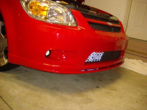

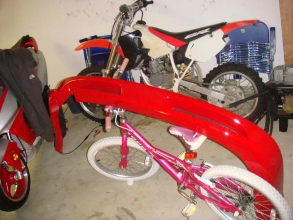

Now you just need to put the bumper back on the way you took it off and put the headlights back in, and it should turn out like this:

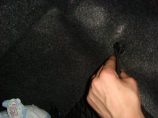

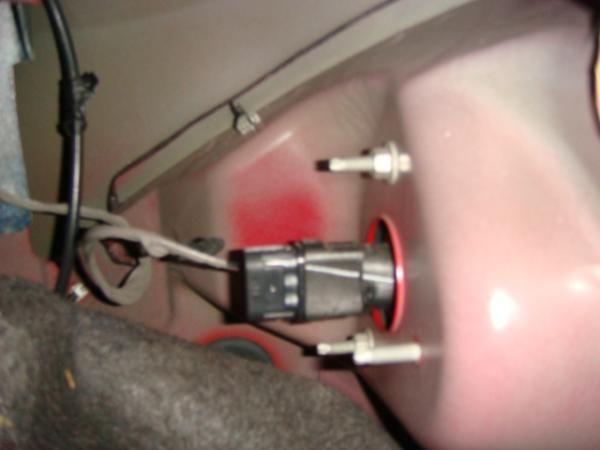

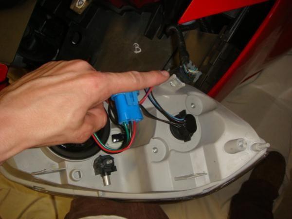

Pop the trunk and unhook the cargo net, after it is unhooked the hook actually is a nut too, unscrew it with your hands.

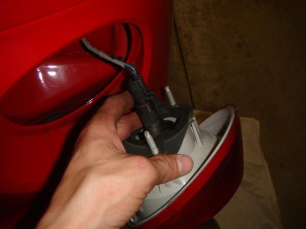

Pull the trunk lining forward now, there will be 2 10mm nuts there, unscrew them and your tail light should come right out.
unplug the tail light and set it to the side.
repeat those steps for your other tail light.

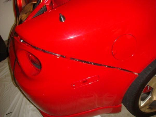

Step 2: removing the bumper

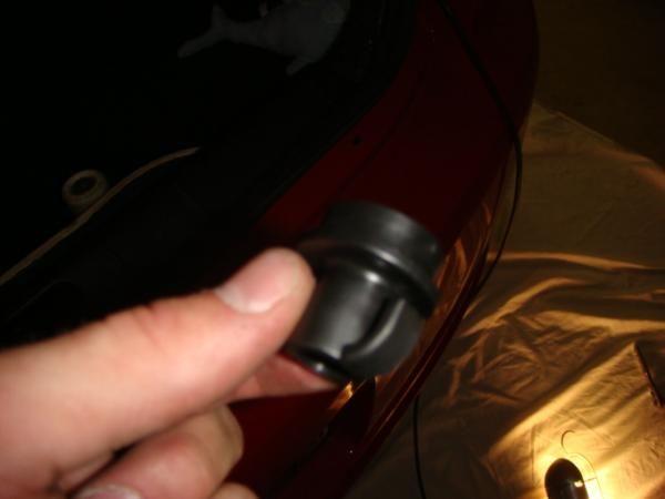

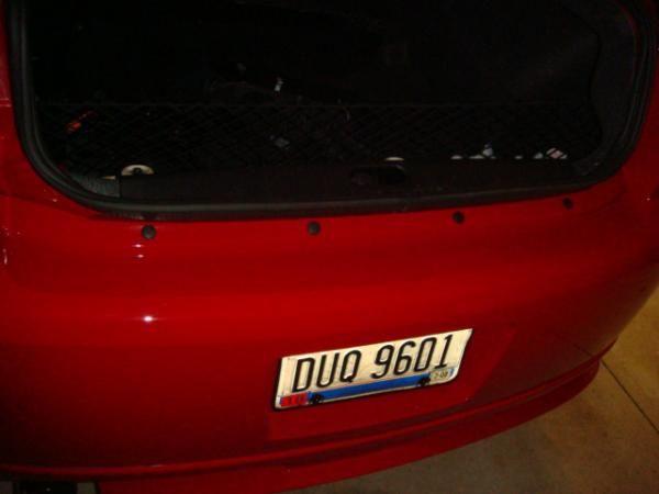

next remove the 4 push pins that are across the back of your bumper

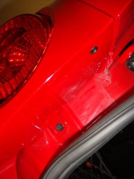

now you need to remove these two bolts, one is a small standard size allen key, i am not sure what the size is, and the small bolt is 7mm, these are on both sides of the bumper, remove them all.

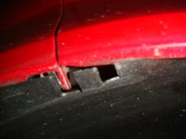

this is the hardest part of the entire install, take your 7mm midget wrench and start taking out the bolt that is behind the little flap shown in the picture, it is such a pain in the ass, there is one on both sides.

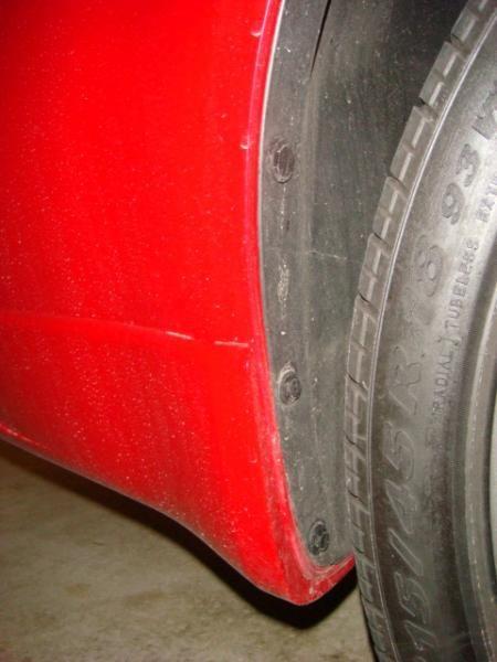

remove the 4 push pins inside the wheel wells on both sides.

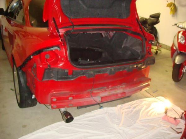

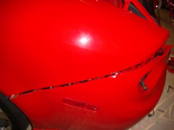

once you have completed those steps your bumper cover is almost ready to come off, pull on both sides and the cover will just peel off, its not ready to come off yet though so be gentle.

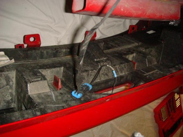

underneath the car there is 4 more push pins holding the bumper up, pull them out. your bumper is ready to take off now, but there are wires attached to it so dont pull it hard or far.
unplug the side markers on both sides
unplug the liscense plate light, your bumper will now be free from wires.

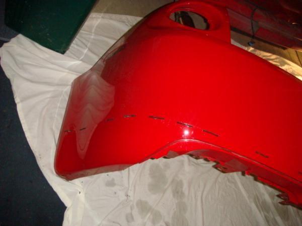

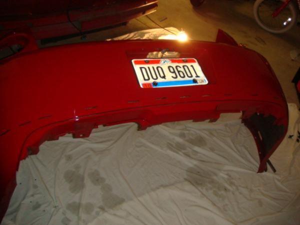

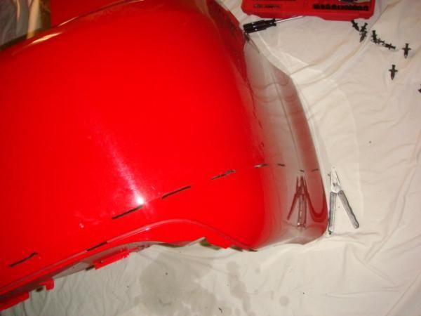

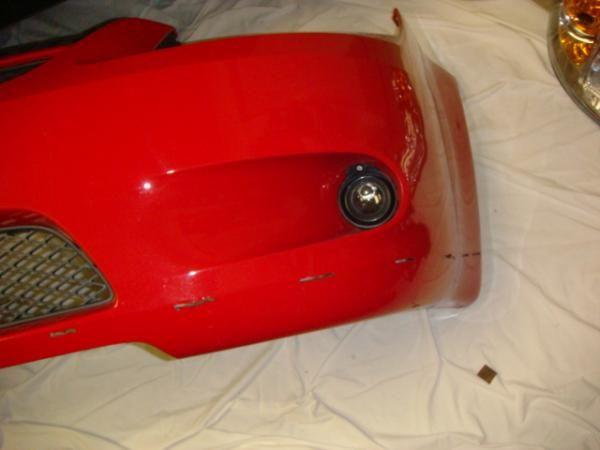

first you will need to remove the rear grille that is already on the ss/na rear bumper, after you do this cut the slits like you did on the front bumper, once again they are also clearly marked on the inside of the bumper cover.
you are now ready to put the lip on.. So Do It!
once you have pushed the lip on, put all 14 of your clips in place.
after you put the clips on you will need to put 4 push pins in the botom of the lip connecting it with the bumper.
you also need to put a push pin on the end of both sides of the lip connecting it to the bumper.

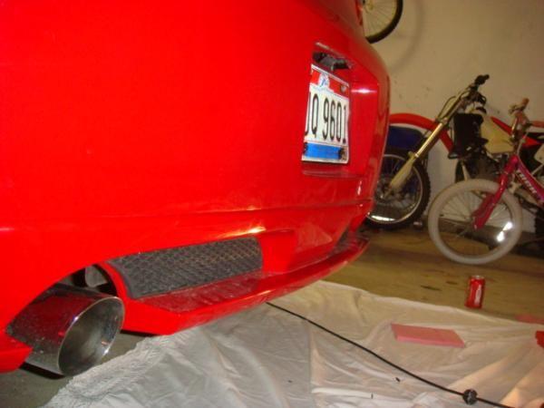

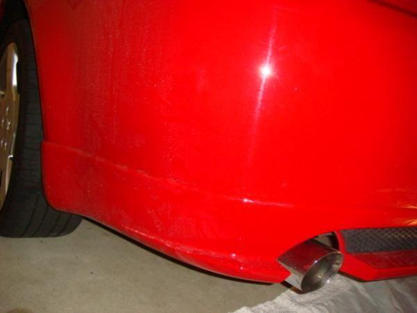

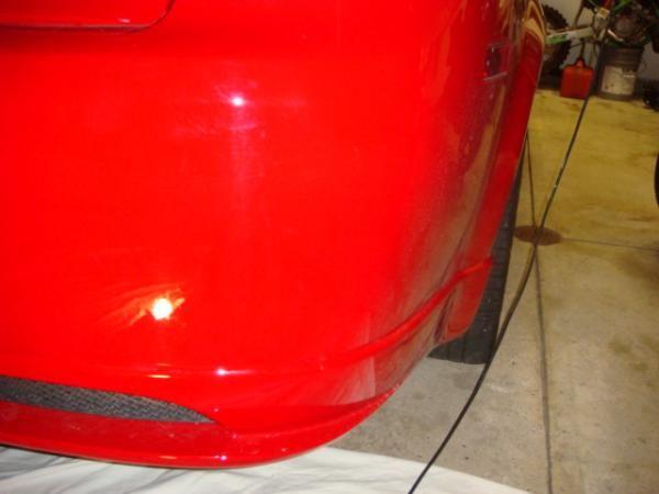

reinstall your bumper cover and your car will look like this:
