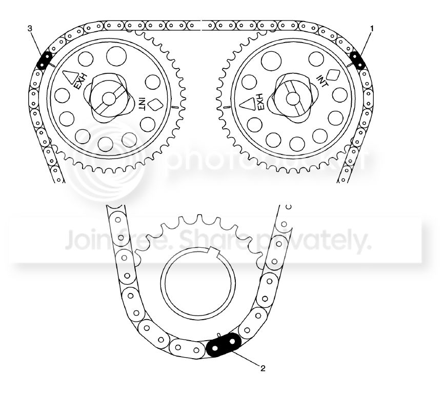

So you've lined it up like so:
And even after you've popped the tensioner out it's still that loose?

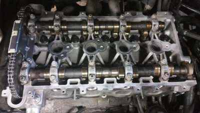

jmelton327
Mar 18, 2015
18
There are pictures I took the new gears off and put old ones on to see of there was a difference but nothing I did break one of the notch on the back side of the one gear that goes on the cam it ws the newer one that came with the timing chain kit noticed that when changing them once agian that was removed and replaced so that is not the loose issue but figured I would throw that out there

jmelton327
Mar 18, 2015
18
Long at my pictures and urs I feel like the black marks on the chain are off let me know what u think
