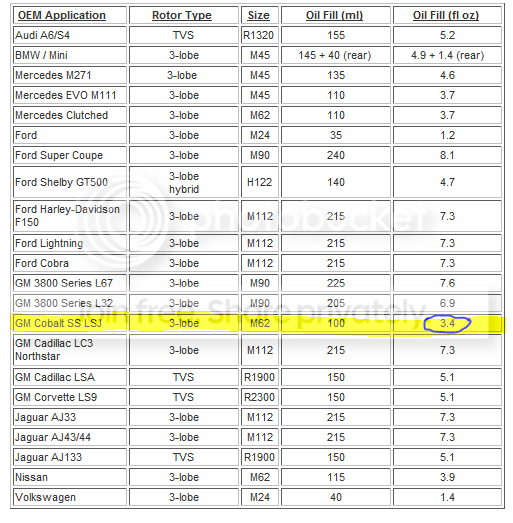

On many howto's for supercharging the 2.2/2.4 or even just the how to for replacing the oil in the m62 I have seen many people say you need 2 bottles of oil which is over 8oz's, this is wrong!...And all the arguing in the "how to change your M62 oil thread" just confused me more...SO straight from Eatons website here we are....Hopefully this will help clear the questions and misinformation..perhaps a sticky?

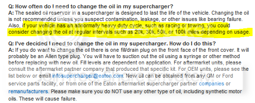

Source:FAQ for Superchargers
If your still questioning it...'

Please show me your data proving they die between 100-125k without an oil change. They are designed and tested for 150k miles and pass with flying colors.. How much oil do you think they loose on a 150k mile test?

lol, I may be wrong..but I def. don't think I am.....you def. don't need 2 bottles to change ur s/c oil....If you overfill the snout then you will build minimal boost if any at all....the actual spec 2.5 fl oz. or around 75ml....the 2 bottles eveyone writes about is for an m90 on a grand prix........I have used 1 whole bottle of the s/c oil before and couldn't get my car to build any boost under full throttle.....When I switched s/c's under warranty and we drained my old one that's when we found they come with around 75 ml of oil from factory.....
you need to fill it with 100ml or 3.4 oz from a completely drained state.. adding 2.5-3 oz would be typical for an oil plug drain because thats what you remove.
You guys are just adding more "windage" frictional losses into your supercharger. It definately wont stop you from making boost.. but it will overheat your oil and push it past the seals

it only gets 100ml (3.4oz) of oil from the factory... thats all it needs for 150,000 miles with no oil changes..

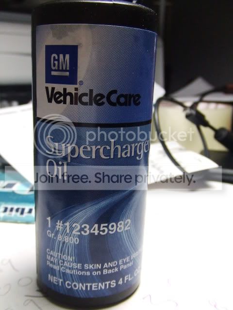

This cracks me up, show me 1 document from GMs "Service Information" that gives you a service intervale, part # of the proper oil or procedure for changing it. There are none. That oil part# if for the older 3.8l superchargers, the m62 we have is filled with a synthetic. Eaton doesn't even recommend changing it, as well as GM, hmmm. Also to fill it to the proper level you need to remove the SC and lay it flat on the bench, then fill it to the bottom of the hole, this will be around 3oz, just FYI.
I e-mailed eaton supercharger info and they told me 3.4-3.5oz. I am going to stick to this; many of you have put 6 oz. in and maybe its working fine for you and thats great, but the rep told me 3.4oz. so thats what i'll put in.
