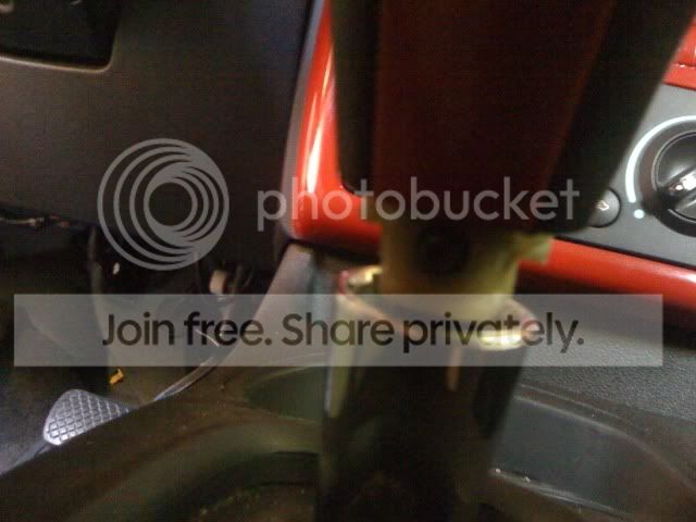

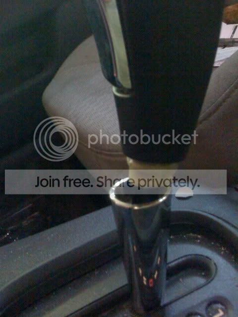

Grab the chrome piece at the bottom of the shifter and Twist it Counter Clock Wise WHILE pushing it down. Here is what you will get:
Step 3.

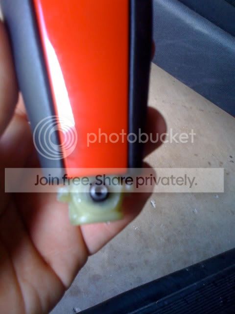

Located on the exposed brown plastic on the backside of the shifter is a screw. Get your Allen Key and unscrew it a couple of turns, you don't have to take it all the way out.
A better shot of the screw:

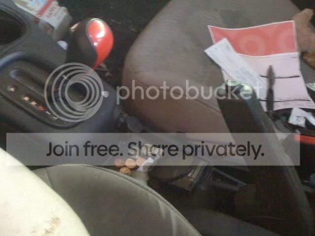

Pull it off and you now have successfully removed your automatic shift knob :D
