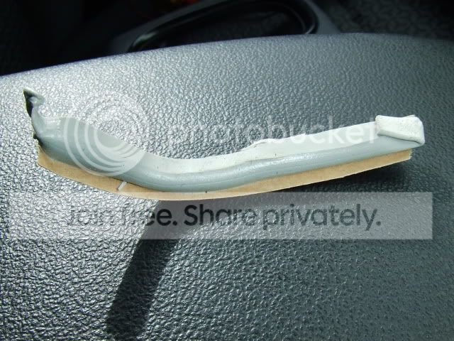

-Weather striping tack(ill find out the correct name later today)

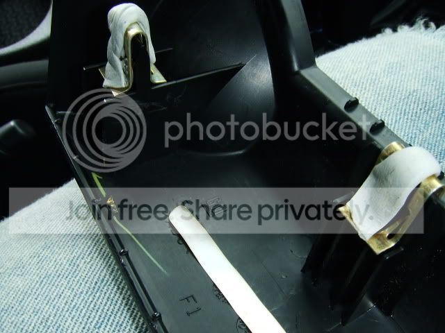

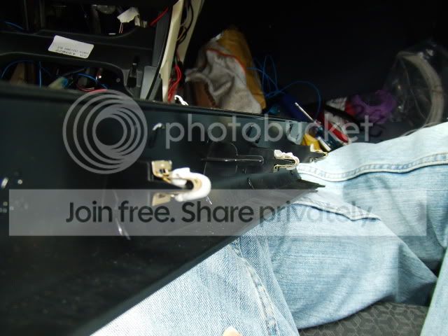

Remove your trim, You will see behind each bezel, there is a metal tab, thats what rattles and squeak's against the plastic.
tear off a little piece of tack and lay it on all the metal clips like so
reinstall and you are now squeak free! :)
