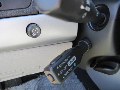

got an aftermarket CC installed in my driveway by a mobile electronic guy,about 1 hour and no dealer programing,he pulled 2 side panels in front of console and one on side of steering column and drilled one hole to install switch.This cruise is lots smoother than most i owned.If you press resume say 15mph lower than your speed it doesn't floor it but brings it up normal.See pics attached.You can see it at thecruisecontrolstore.com item 250-9506
