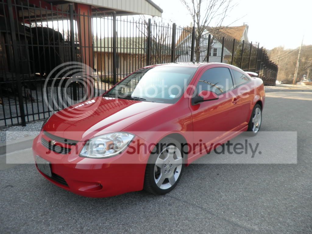

When I first brought her home.

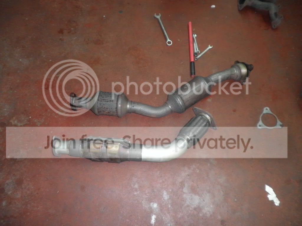

ZZP midlength DP next to the LE5 auto dp (it had to come off manual zzp pipes will not fit auto 2.4s.)

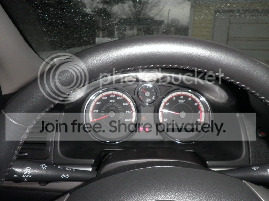

LNF 160mph cluster

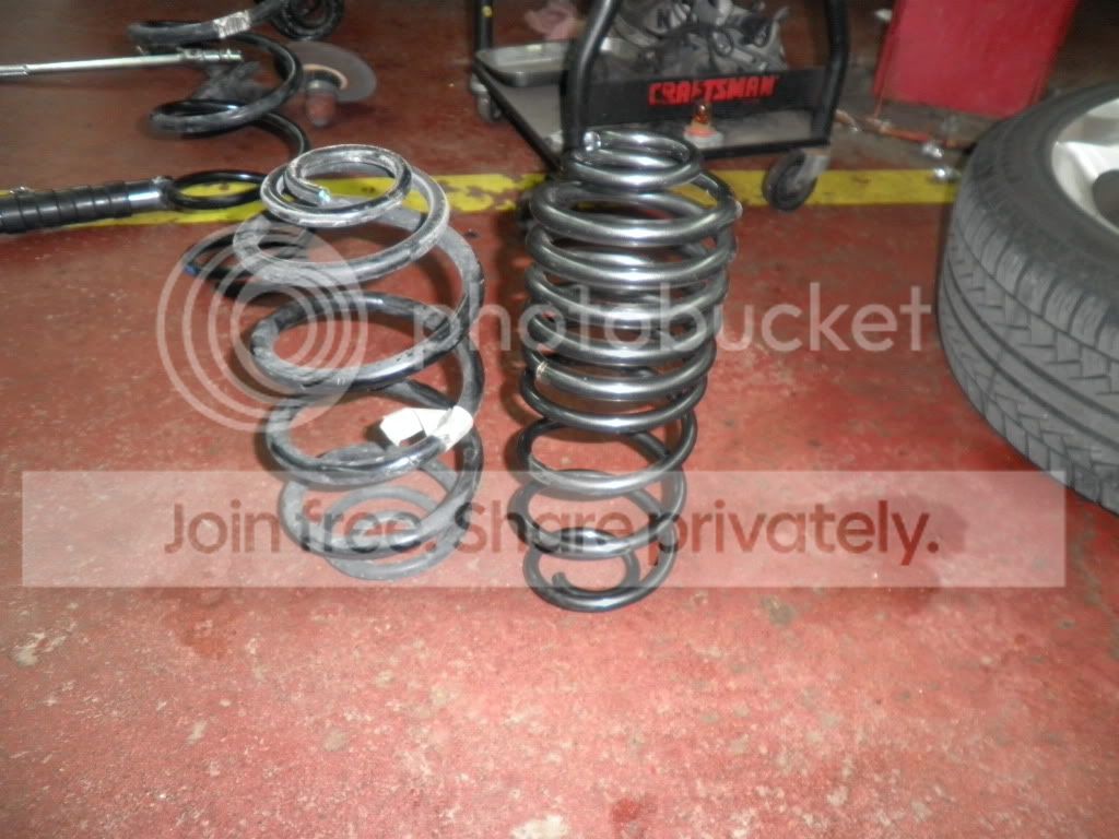

Eibach Pro kit springs (rear) Next to stock FE3 rear (FE3 is the same as FE5 rear)

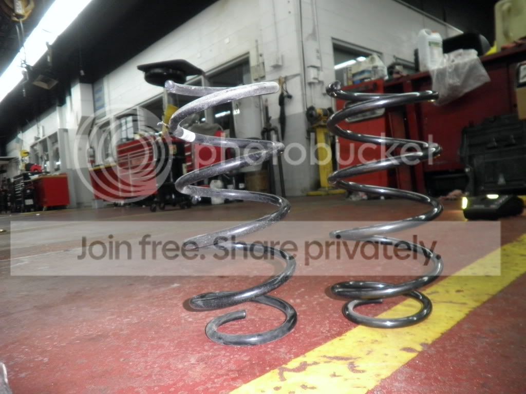

Eibach Pro kit springs (front) Next to stock FE3 front (FE3 fronts appear to be their own but must be closer to LSJ FE5's)
Before springs
After springs no real difference in ride height. the factory rear rake is a bit less. Ride quality on most surfaces is near stock. When its rougher you can tell it has different springs in it. Cornering is a lot flatter.

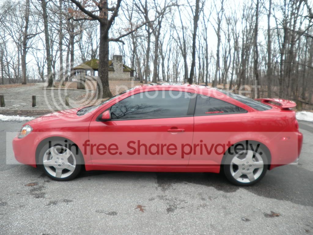

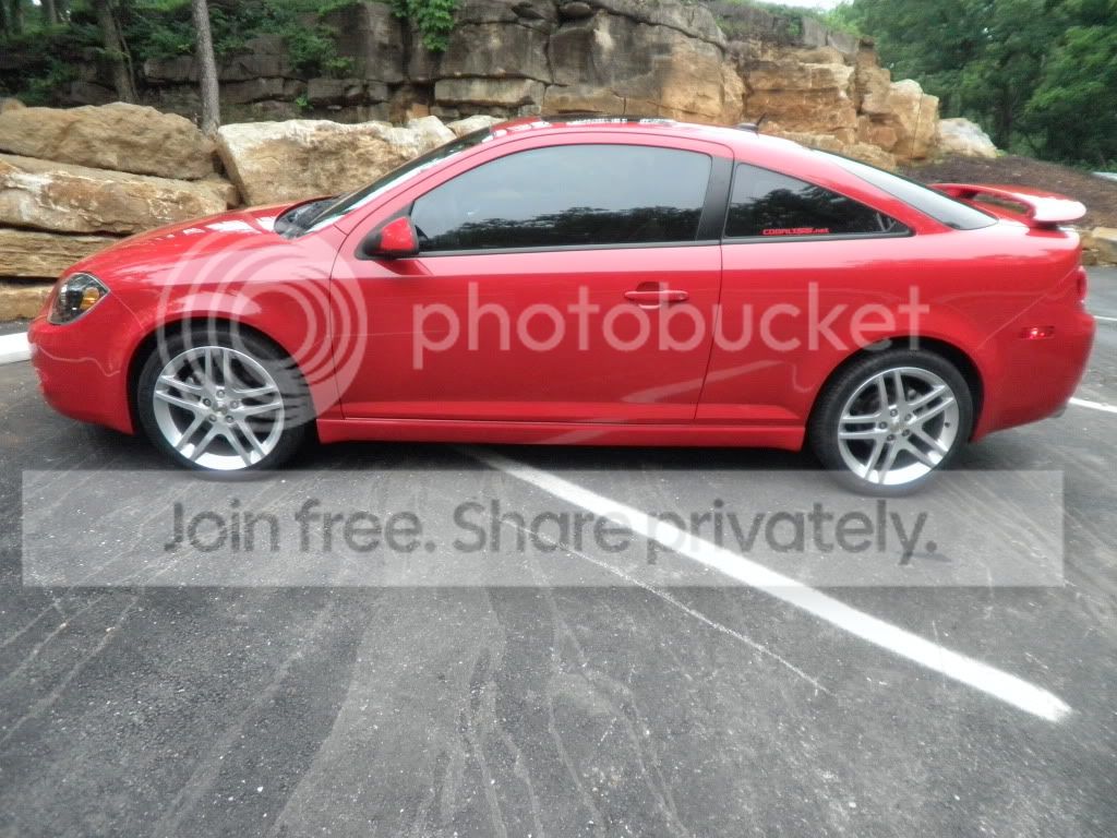

09 SS/TC (LNF) wheels with Kumho 235/40/18 spt tires (they were 78 bux a pop from tirerack!)

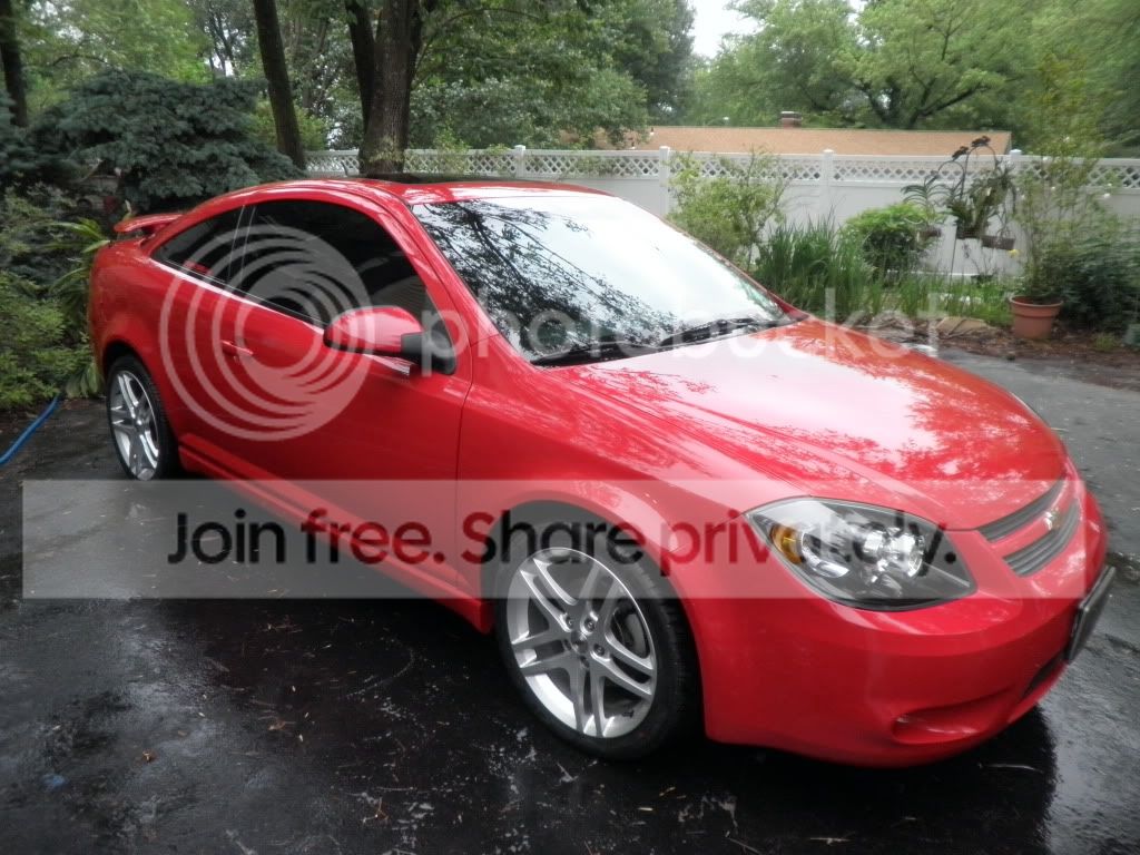

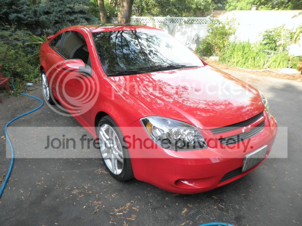

Few new pics of the car with a quick wash and the new wheels....

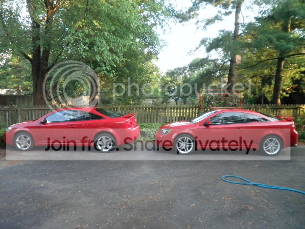

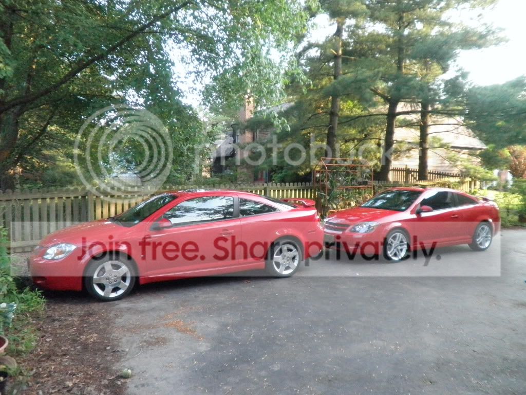

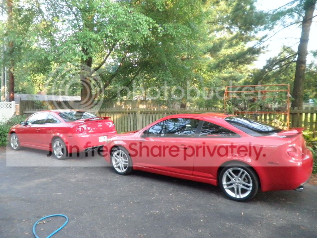

heres a few more pics. Since my families car was here figured id get a kinda sorta before and after pic.
Both cars were identical to each other. Even purchased the same day.
Figured this is a good way to show the difference in the springs wheels tires headlights and tint.
And man am I so glad to be off of those SS/NA wheels!!! I didnt really realize it until this pic :lol:

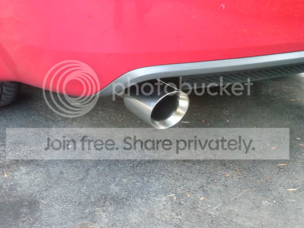

SLP Loudmouth II catback

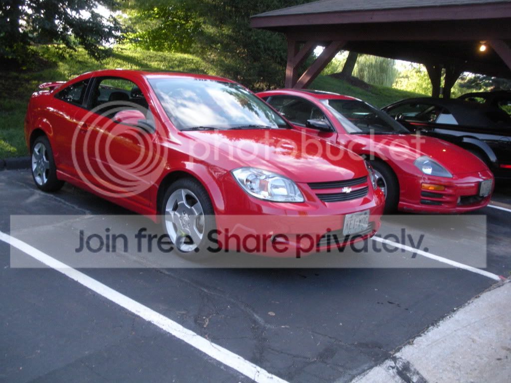

One from the local cobalt meet (new forum small turnout)

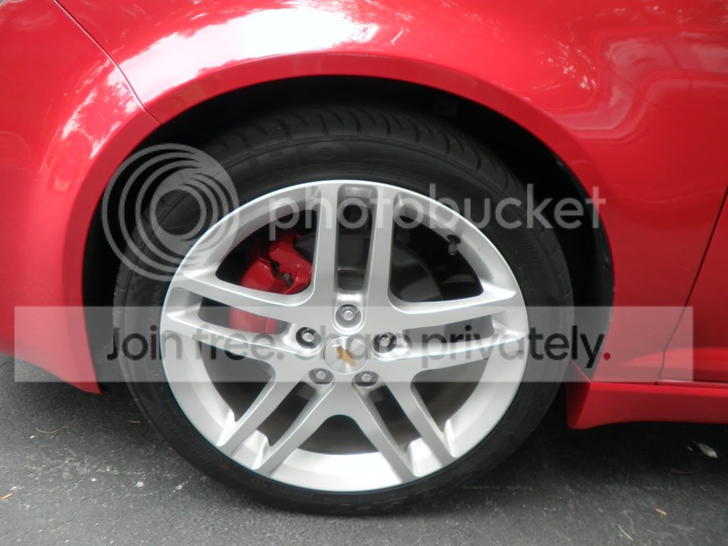

Got tired of the rust marks on my calipers and them looking dirty so just gave up and sanded and painted them. Still thinking of repainting them black though...

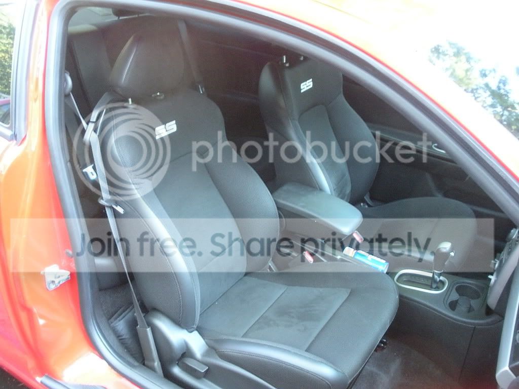

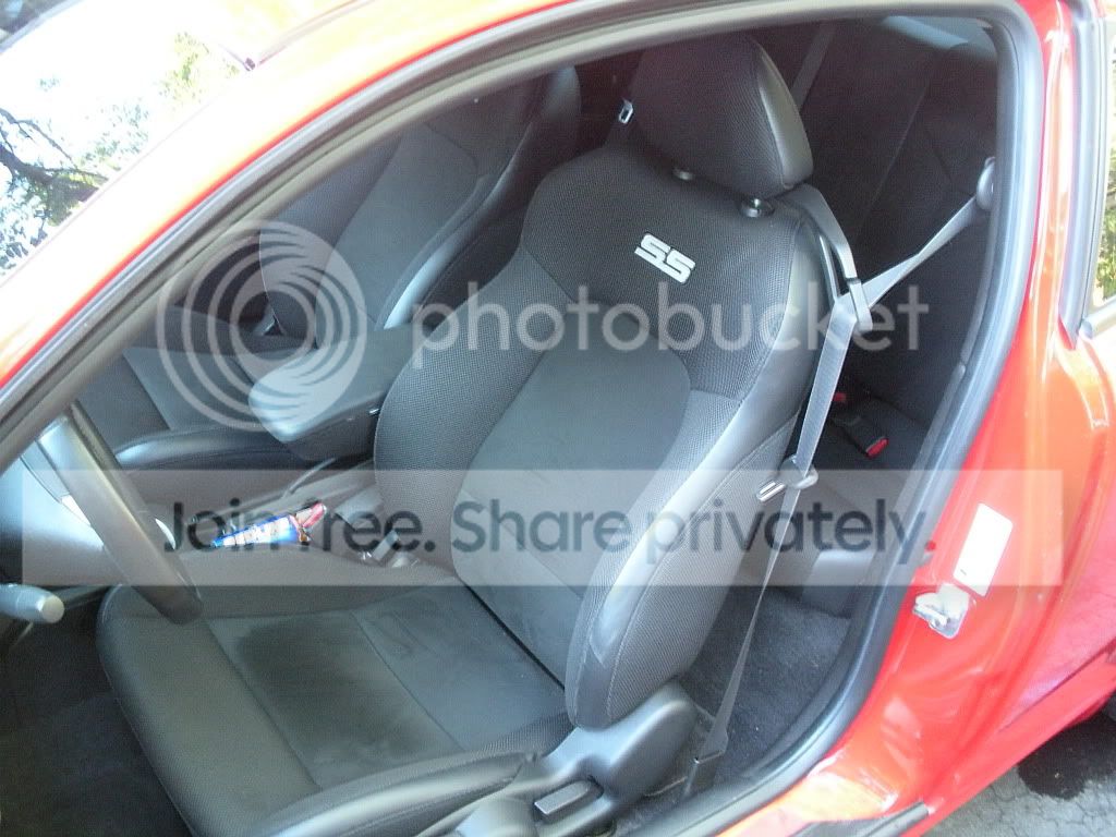

Another small update Cobalt SS/TC seats!

Nice, Whats the deal with buying downpipes with the auto?
Rich
Jul 17, 2010
9
I had a manual zzp catted 3 inch downpipe for the midlength and it rubbed on the front swaybar. It also pulled the whole exhaust inward. Enough so that my exhaust tip was almost behind the rear bumper. Auto downpipes are slightly longer and angled a bit differently. So at least with zzp you need to make sure its an auto downpipe (though a 2.5 may clear but it would still be close).

Thanks and the SS/TC parts really do make the 2.4 feel like a much sportier car! I actually got the ss/tc seats as a straight swap!

welcome i have a ZZP 2.5 dp on my auto it doesnt rub. it does pull the exhuast in a bit but i kinda like it
