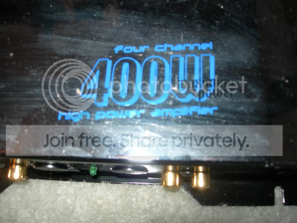

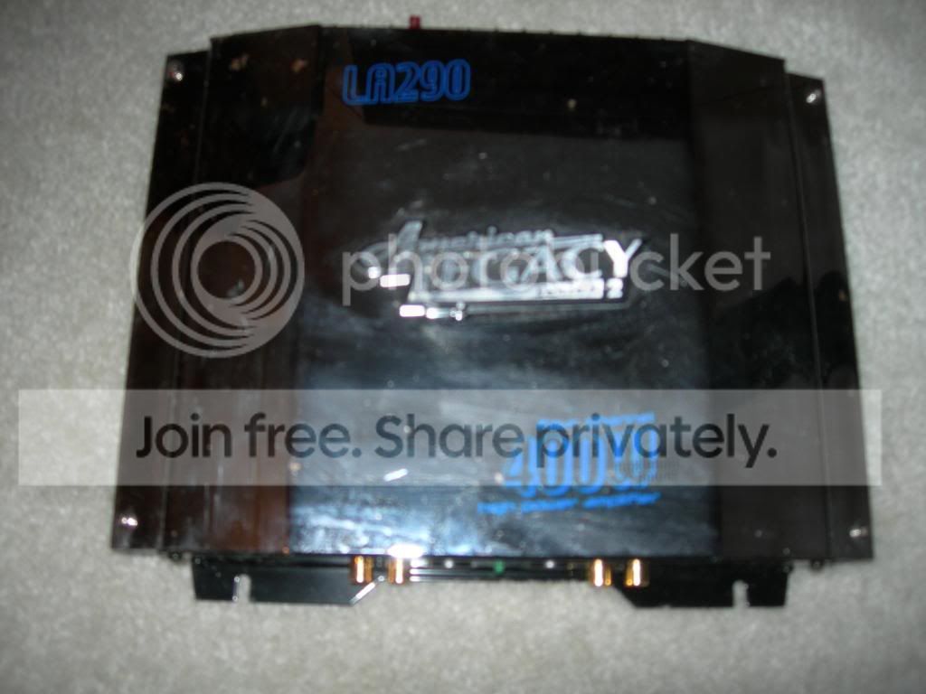

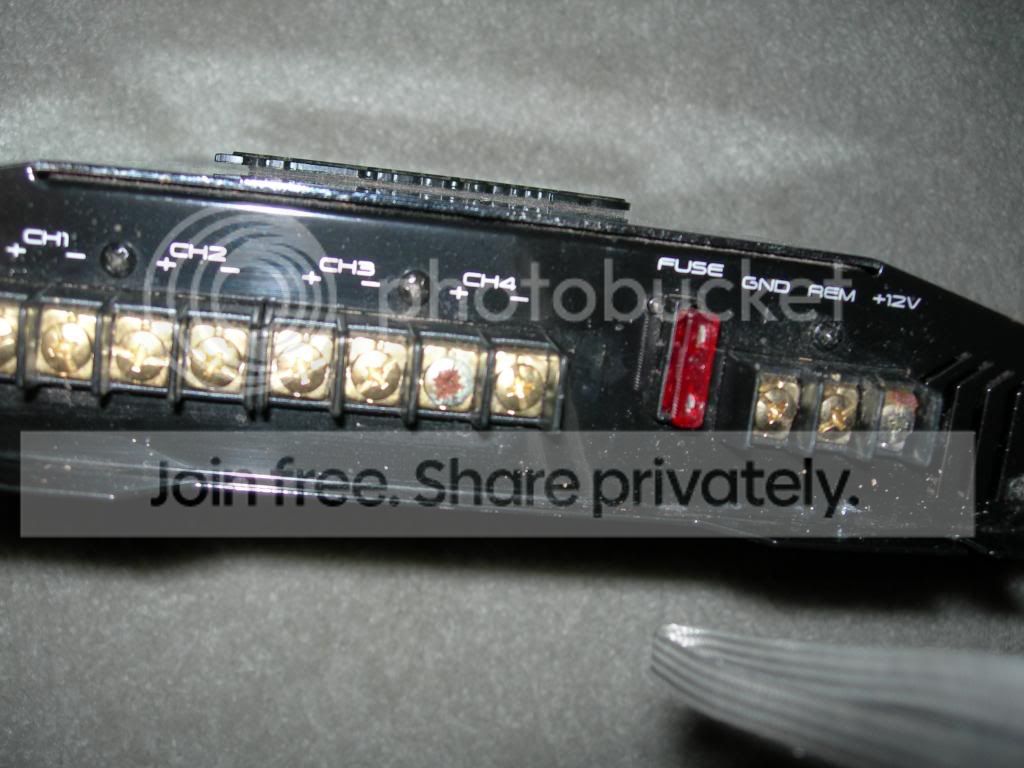

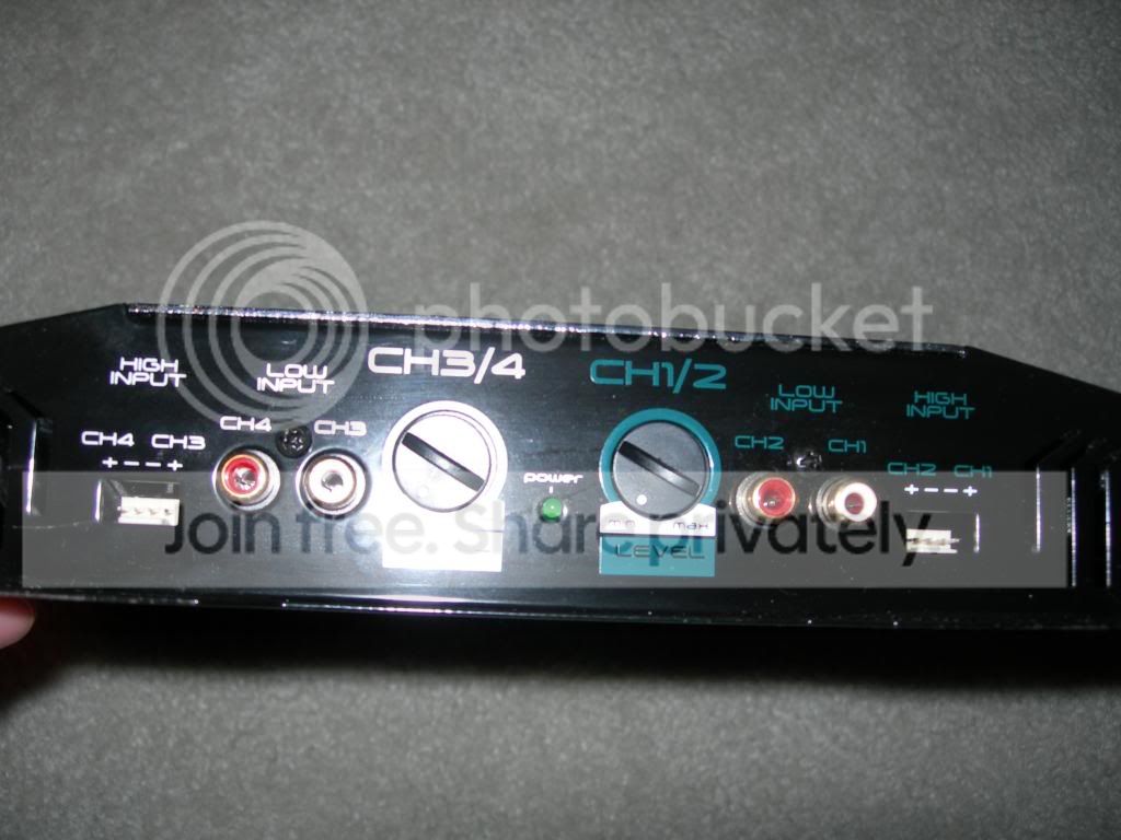

ok i have this amp and im deciding wether or not to put it in the car. Its a 4 channel amp for my speakers. My questions are do i tap into the speaker wire with the wire from the amp and only hook up the original speaker wire or do i just twist the 2 together and then hook them up to the speaker or do i just hook up the amp to each speaker. Also there are 2 rca spots do i hook up 2 rca spots i would think i needed 2 rca cables but im not 100% on that. Also on my radio there are 4 plugs already plugged in on my dvd head unit i would think those 4 would be the speakers right now but im not sure. Also i already have a power wire hooked up for my other amp would i be able to tap into that before the wire reaches the rfuse and run 2 wires off of that 1 fuse or would i have to do a completly different wire. Any help would be good thanks.

To run the amp for 4 speakers you need at least 2 rca inputs, 1 left and 1 right from the deck to the amp unless you use a line output converter to provide rca outputs for the amp or use the high level inputs to the amp. Easiest and most cost effective is a set of rcas from the deck to the amp, for a 4 speaker setup I like to run 2 sets of rcas for all 4 channels (1 per speaker) . You will need a minimum of 14 gauge wire to run a set of amplified speakers and the speaker wiring in the base cobalt is much smaller. If you have the amplified sound system from factory then you are good to go for that part. The good news is that if you have the base set then its really easy to run the aftermarket speaker wire to the front speakers through the rubber door molex connector, you don't even need to drill holes in it, just open the door all the way and pry the molex out of the body then remove the rubber, the plastic molex has openings all along the outer ring that you can easily run speaker wire through. Just run it through that plastic then into the rubber connector into the door and then put the rubber back of the plastic and put it back into the door. Super easy to do and does not take much time. Just make sure that all speaker wire is run along the factory channels to protect it from damage. You will need to remove the door panels, the rubber molex connection and then the sill it all pops up easy enough for the door sill, pull the front part towards the inside of the vehicle, the pull the long part straight up just make sure you don't yank on it to hard and break a clip. I use a plastic pry tool thats specifically for panel pulling but a wide plastic scraper works just as well. You can use a power distrbution block to tap into the amp power wire that you have but you will need to increase the fuse amp rating to accomodate a second amp, and then fuse both amps between the amp and block to avoid damaging either amp. Also make sure that before you touch anything electrical then you need to disconnect the negative terminal of your battery first and connect it back up last to avoid blowing fuses. If your dvd deck has 4 rcas connected to it already then check your amp its most likely a 4 channel amp with 4 rcas plugged into it already. They usually do not use the rcas to connect directly to the speakers but some car audio installers do.

thanks for all the great infor yeah my car is the base model and did not come with the facory amp. Also when i had my head unit installed there were no subs or anything just the head unit and the speakers so i think the 4 plugs are for the speakers ill try to get a picture of them later. But with what your saying either way im going to have to get a 2nd fuse i was trying to cut that out to save the $20 but i guess i dont want to cut corners either.

trust me wiring is 1 thing you want done right the first time around, I have been around long enough to see what happens when people cut corners with it and the consequences can be pretty bad. Most decks come with 4 to 6 preouts these days, 1 for sub and 4 for speakers or 2 for subs and 1 for speakers. Mine has 4 but the last 7 dvd units has 6 on them that I put into various cars. Any questions feel free to pm me or add me to msn messenger if you have it, my msn is [email protected] just make sure that you put in there that you are from this forum, if you add me without any notes to identify yourself I block the address. here is a link you can check out as well for wiring through door connections. http://www.the12volt.com/installbay/forum_posts.asp~TID~78731~PN~1
