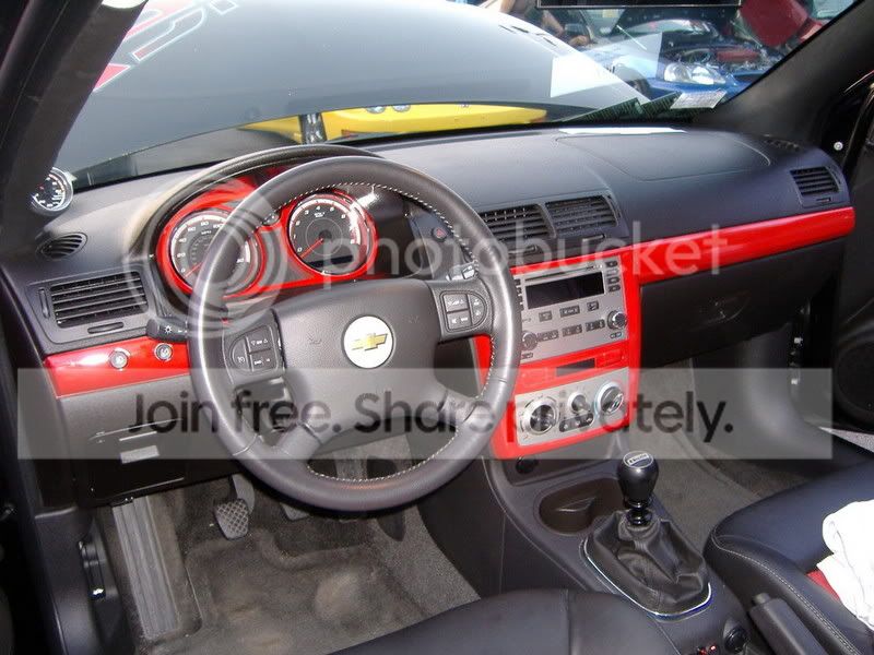

Here's how I painted my dash pieces, sorry I didn't take pictures during the process but it's not really essential for this how-to. These are just my reccommendations for the process, based on what I did.
Your results will be dependent upon your prep work, patience, and the area in which you are painting. I used a home-made spray booth with heat and ventilation that was made of plastic painters drop coverings and is close to dust-free.

End result:
Also a note on painting plastics, do not attempt to remove paint with chemicals. Sanding is the safest way to remove and prep your surfaces. I tried prepping my dash with reducer and it melted the plastic, no joke. Dont do it.
