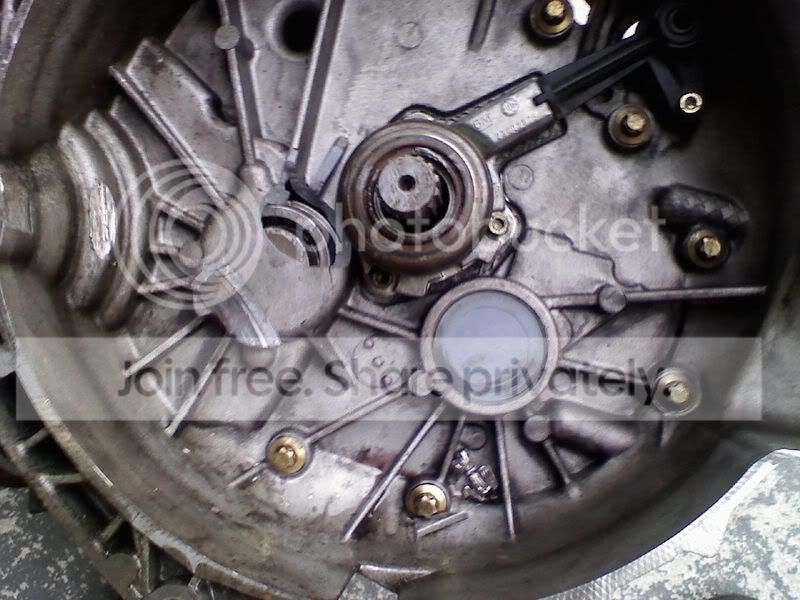

I'm guessing something broke that part of the housing next to that spline gear/input shaft....what happened?

the guy put a teamgreen in and i'm assuming didnt torque the pin in the diff. it slid out shot the insert out of diff and took out the weak bearing on the main shaft.
