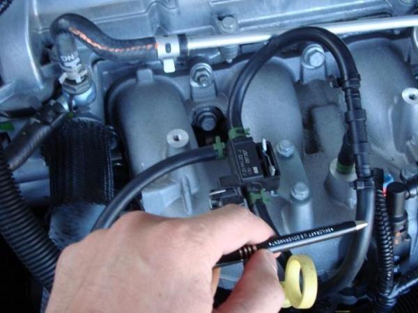

If you want to run a block off plate here is the way I ran my vac lines ignore the pen I'm using as a pointer. I was illustrating something for a question someone asked.
On my lower CP there is no nipple for the vac line that goes there on the stocker. It gets deleted. The vac line that runs from the solenoid to the bpv goes onto you new BOV. I run 24psi on my tune with all my mods as long as your BOV works correctly you will be fine. I am having a recurring MAF code probably from the BOV but it can be tuned out. I need to get a new MAF just so I know its from the bov and not a faulty maf before I turn off the code.
my mods: Treadstone Stage 3 including the following: Cold air intake, chargepipes, intercooler, 3 inch catless dp and 3 inch straight exhaust. I'm trifecta/HP dual tuned.
