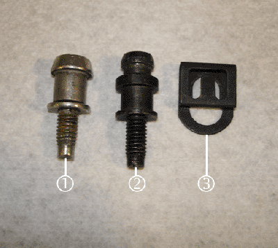

11570937 Stud, Chrg Air Clr Brkt Plt 1
90278102 Retainer, Chrg Air Clr 1

(1) First Design Stud
(2) Second Design Stud
(3) Retainer Clip

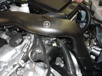

Locate the charge air cooler (CAC) duct (4).

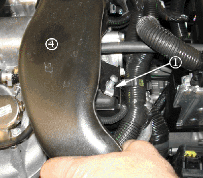

Remove the CAC duct (4) off of the first design mounting stud (1).

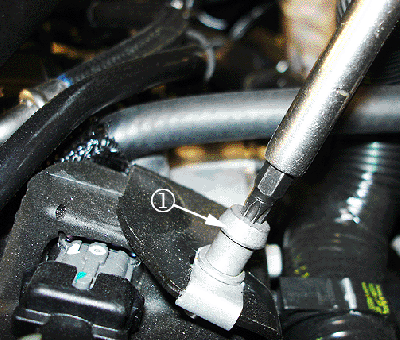

Remove and discard the first design mounting stud (1).

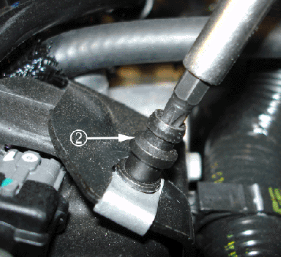

Install the second design mounting stud (2).
Secure the CAC duct (4) onto the second design mounting stud.

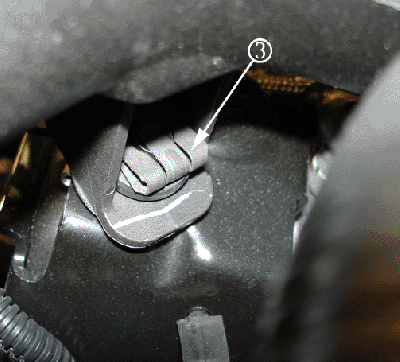

Install the retainer clip (3) to the second design mounting stud. Ensure that the retainer clip is installed properly.
