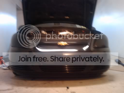

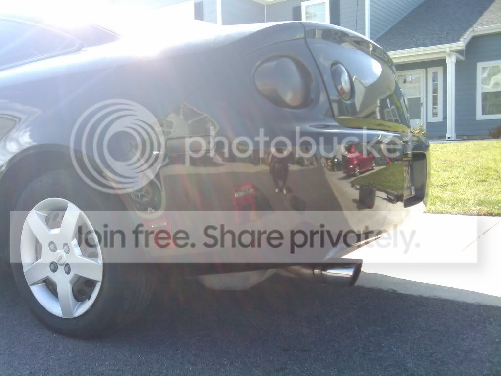

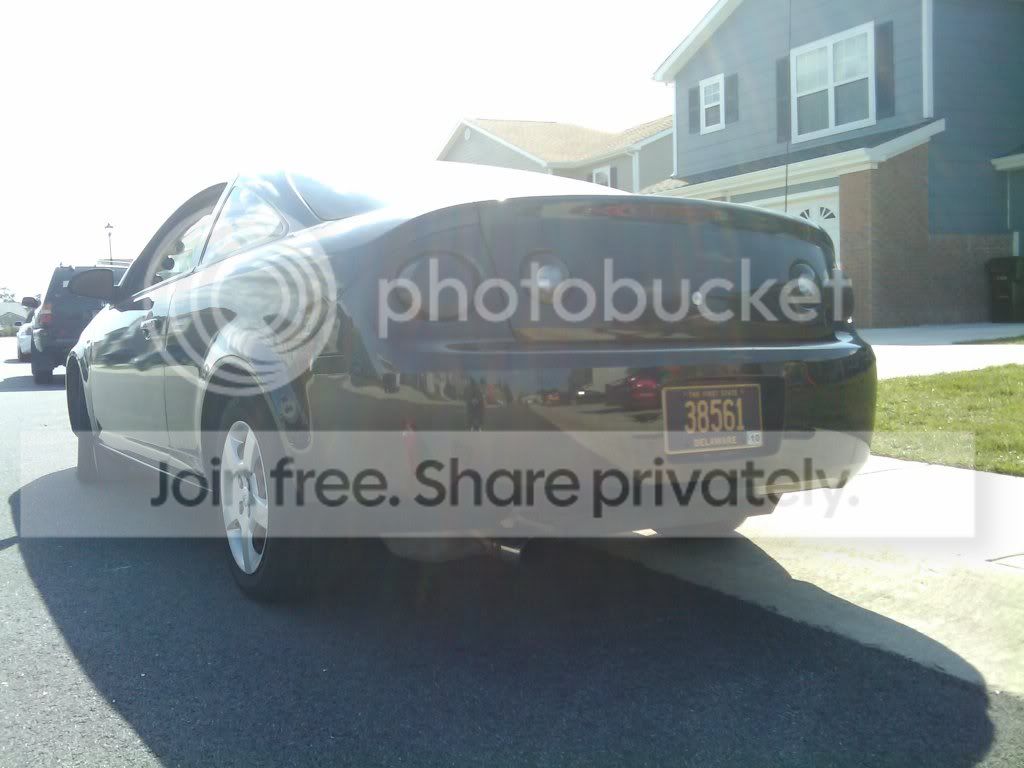

couple pics of her while shes sleeping in the garage

lol, the cobalt is lowered. it only looks that low cause my garage has a little step that goes up a couple inches that the bumper sits over

i believed its as low as it will go. if you know any secrets to lowering it more please let me know. i wouldnt mind letting it lower a little bit more

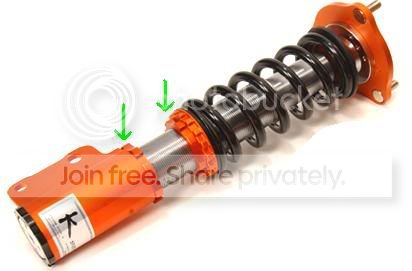

oh wow that is really high. well one thing you can do is remove the two lower locking perches. if you bottom the spring out there's no need for the locks anyway. anything else requires modification and I'm sure you don't wanna mess with those purdy k-sports. i bet they handle amazingly.

ive considered cuttin them. i talked to fastl61 about it and he said they handle just as they did before he cut them so i might go his route

no no no doooo nottt cut them. you can order custom springs from ksport for a very fair price. my springs were cut, i was tucking tire with great stance but poor wheel fitment. my only suspension was my tires. i was riding on bottomed out struts. i did go overboard with the cutoff wheel but it was also a noisy and unhealthy ride. it was beating up the car bad.
