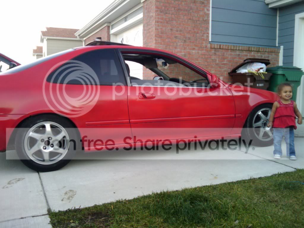

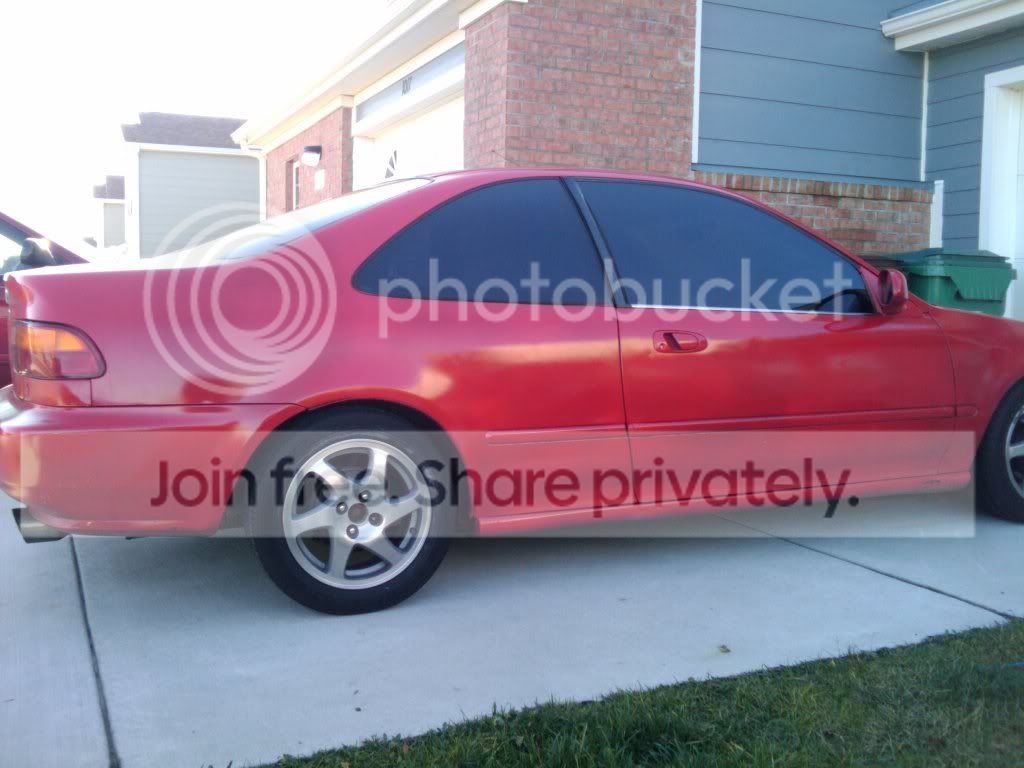

couple pics of her while shes sleeping in the garage

oh wow that is really high. well one thing you can do is remove the two lower locking perches. if you bottom the spring out there's no need for the locks anyway. anything else requires modification and I'm sure you don't wanna mess with those purdy k-sports. i bet they handle amazingly.
the way i lowered mine using my ksports was i moved my spring perch UP.. moving it down will mmake it set higher

and im pretty sure he is lowered on the ksport springs not the coilovers.. might bewrong tho :p

yea. cobalt = springs, civic = coilovers
oh shit, i feel stupid. i thought ff drift meant i can move the perch on my shocks lol. i just realized that

right, the bottom locking perch will adjust the strut height in the knuckle bracket. i think i sort of explained it wrong so my bad. you can't lower the strut too much or it will start hitting the cv joint. as for lowering the spring perch, it will adjust ride height slightly due to lowering the spring rate and allowing for some sag. this kind of setup is strictly looks.
now this is just on coilovers. for springs, b&g springs will drop you to almost tucking tire status only in the rear. the fronts are yet to be figured out. stock struts just don't wanna go that low.

looks sexy as hell man. win. how do they work at night w/o fogs and with the hid's? i was just afraid to drive around with them b/c of cops and stuff but honestly the car looks fresh

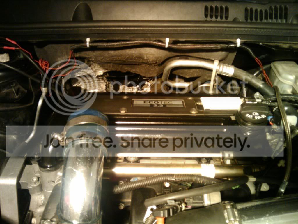

actually i just got done paintin it lol. i painted the emblem and valve cover. i gotta do my 3rd brake light but i dont feel like it right now. ill post pics in a sec. i actually havent had a chance to drive it cause im waitin for a new turbo manifold but i turned the lights on in my garage and they arent super bright but they let enough light thru. cops in dover are a joke. all i gotta do is show them my military ID and theyd let me go wit murder lol
