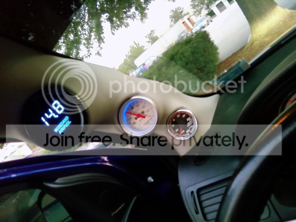

I don't have any pics of where I put the probe I have a pic of my pillar at the time..
best pic I have sorry
