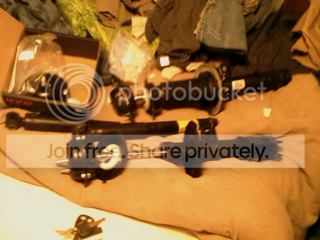

all the suspension stuff i have.. just waiting on the coils.. which i accidentally shipped to the wrong place RAWR

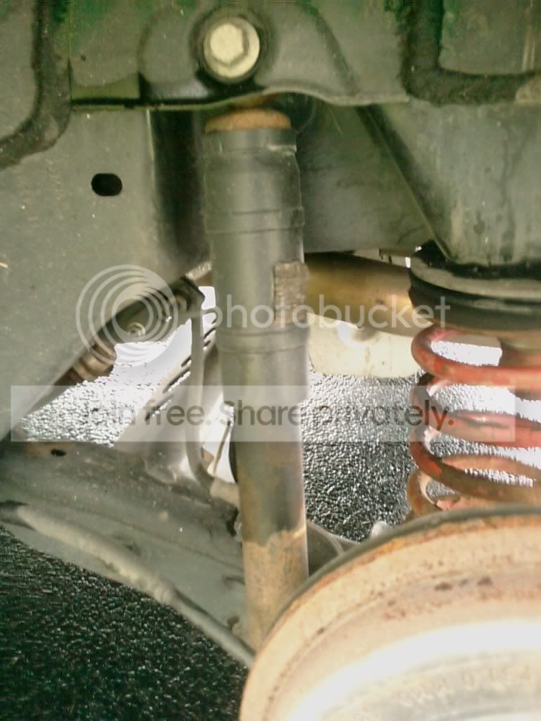

stock shock with the car jacked up.. the shock was just about fully compressed with the car just sitting on the ground lol look at all the shit around where it leaked out lol

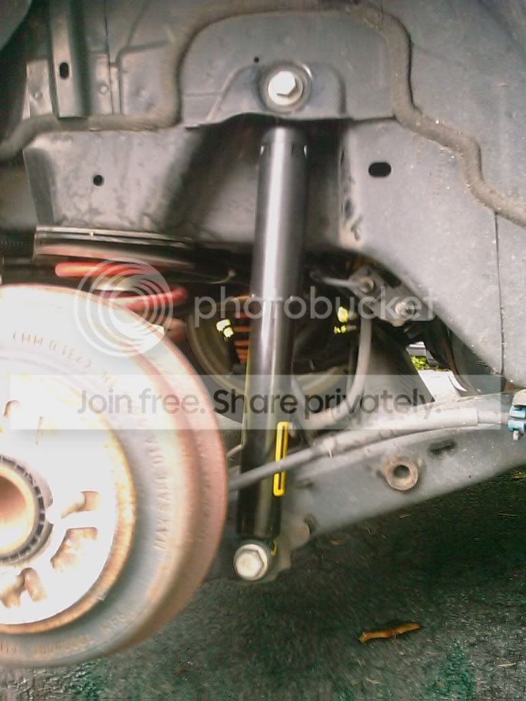

new ss/tc shock installed
video of my goofy ass should a comparison between work out stock shocks and new ss/tc ones
and the review ... HOLY CRAP even with just the rears.. the car rides so much smoother lol .. and it doesn't squat NEARLY as much now..
