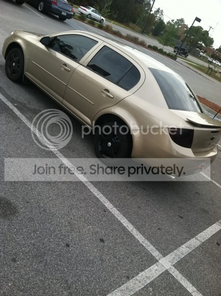

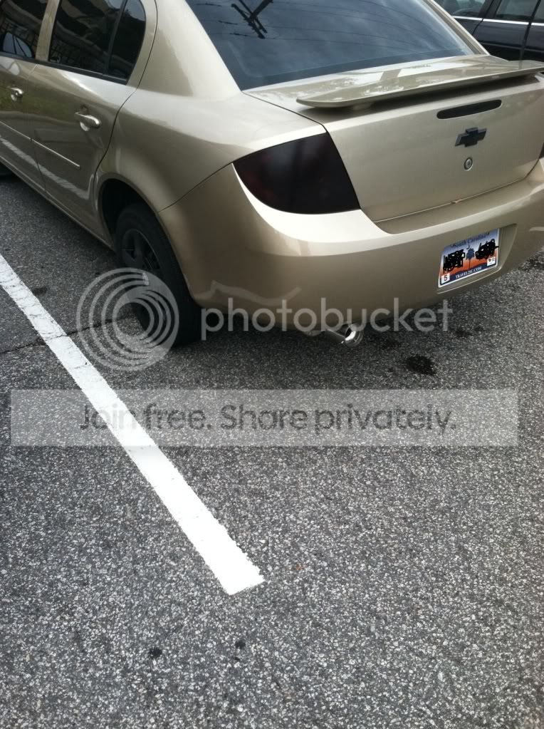

go to O'Reillys and get some clear coat spray paint for your tails, it will give them a gloss finish instead of the flat nightshade finish, btw sand with 2000 grit paper them clean with wet rag then dry it as much as possible. check out my pics for an idea on how they look with clear coat.
I've got clear coat..how many coats do you need? I put on two when I initially did 'em....

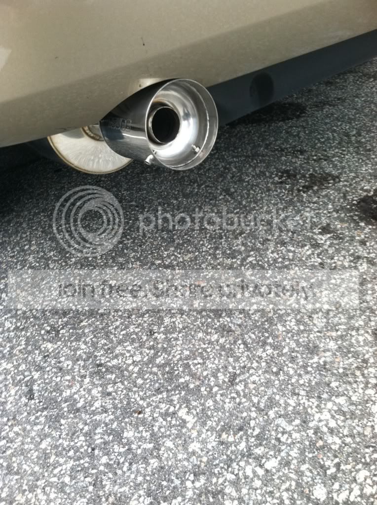

Btw, took off silencer, and sounds a lot louder.

I saw the N1 on youtube and it sounded ricey. Maybe it just my crappy laptop speakers. I'm looking at the N1 myself. To compensate for the low hanging can you just use shorter hanger clips? You know, those rubber things that connect from the exhaust hanger to the car hanger? Or do you have to shift the pipe around?

Its not ricey in person. That was the day of putting it on. I bought super long hangers because there was talk about how it sat too close to the bumper and would melt it. Since then it is sitting perfect with the right hangers.
