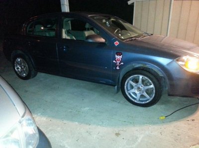

New member, Love my coby! shes done me well, bought it in 2009 at 58k second hand from a used car place, found out it was through a rental company. done the regular oil changes, fuel filters, fuel pumps, air filters, cabin filters, froze up on a trip, towed it, 3 fuel pumps later, to find out the ground wire near the 6x9s was loose. Thank goodness, pretty penny later! 140k now. im no car expert, just a bass head and i self install stereo not car parts! I would like to do cold air intake one day, muffler another through a dealership!

vibrates, wobbles when hitting bumps.
rotors were done 2012 with front breaks
wheel alignment 2013
sway bar links starting to crack but good for another year (according to oil place) he said those i should notice.
GM wants 800 to replace my universal steering knuckle. anyone have this issue? other than that runs great on highway, straight as an arrow, comparable to my moms 2013 cruze ltz minus the new stiff suspension feel LOL! my father in law told me few bolts and i can rip it out of a car at the pick apart with a box full of tools. and after doing that i can put it in myself and save the $800! anyone else have this problem? Im electrical wire friendly and savy, but when it comes to brakes, steering suspension, motor, i stay clear!!
