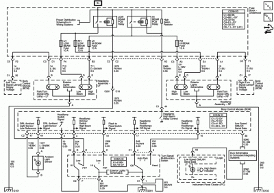

I installed complete head light assemblies on both sides of my 2005 Cobalt. I have checked fuses and connections but still don't have low beams either side. I read someplace that in this case the relay that controls the head lights is in the fuse box base. Is this correct? Many thanks.....mike

Thanks, five7man..............seems there is a relay under the hood tht controls both sides..........I'll check it out.........thanks, again........Mike

thanks for the schematic five7man............I need a "fuse block" that contains the low beam relay
