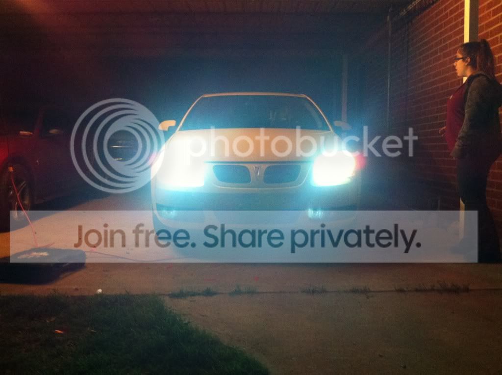

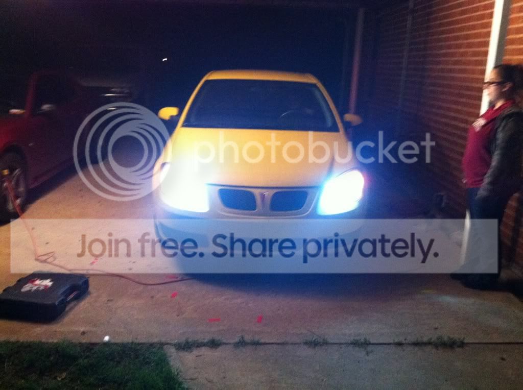

I finally got the HI/LOWs in and installed them a bit ago. I need to aim the lights now though. I think that brackets are just crooked, but that's for tomorrow. But one ballast, and the relay went under the left bracket, and the other ballast went under the right bracket. All with double sided outdoor tape.
Also the install for Hi/Lows is a little more in-depth than singles. With these, I had to tap a power source (unscrewed the pos. jumper post and put it on there) and tap two grounds (driver side had one right by the ballast, but I had to shave the paint off under one of the bracket bolts up top). And the wiring harness uses one of the original bulb harnesses and ran a wire from the relay over to the other side on a wire loom and the radiator support.
6k Hi/Low bulbs.
