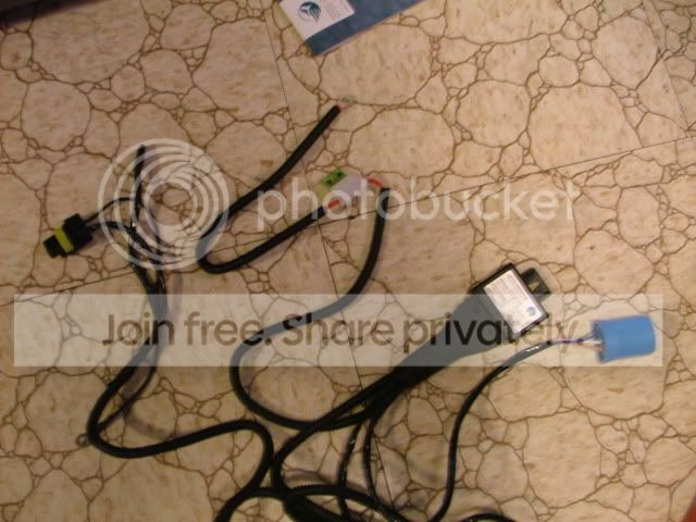

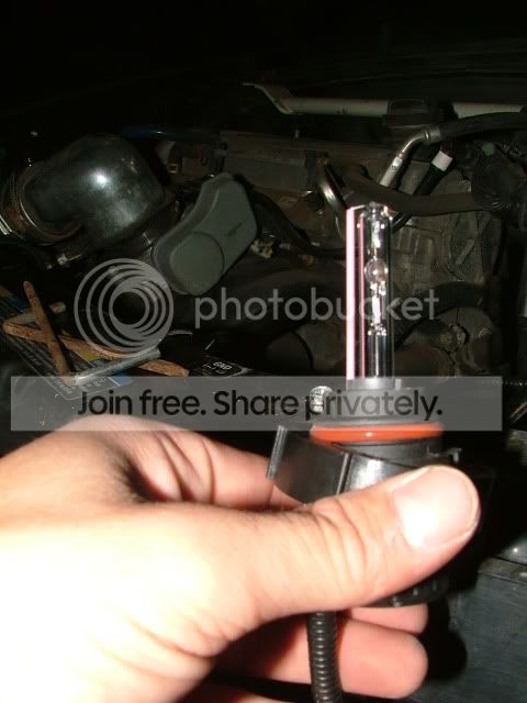

i have a hid kit. its a bixenon. but my high beam is always light on. i can not flash my light.

i dont know much about hid's but sounds almost like the wireing is wrong? or it could be a single balist(only high beam not both)

sounds like wiring to me. did you install the relay and resistor for the highs?
i ve used everything that was included in this kit

what happens when you go to flip on your high's. do all the lights turn off? if they do from my understanding its a single filement bulb.

yup thats exactly what my hid kit does. When i flip on my highs it turns my lights off so they failed me for inspection here in texas saying we cant pass you because your brights wont work.

then put the stockers back in till then. they make a balist that is single and dual. single is either high or low beam only. the dual is both high and low
