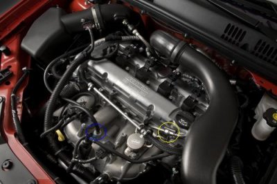

Excuse my ignorance
But is the the silver pipe the one in Yellow or Blue
thanks!!
Neither, it's the long thin pipe (~1/4") that runs horizontally above the intake manifold just in front of the valve cover. It's just to the left of your yellow circle.
Center of this picture, running from the top left to lower right.

Wait, so you poured fluid into the hose that runs to the overflow tank?
bigstar101
Dec 23, 2012
16
Yeah,
check the picture, he opened up the plastic covers,
and undid the hose under the yellow cirlce, and poured antifreeze there
and I saw fluid increase in the overflow tank.
did he jack it up ?
No not at all, but all that effectively did is add more coolant. The system needs to be pressurized to push the air bubbles out of the high point.
So what he should have done is added compressed air into that same side of the line to push the bubbles out of the nipple side.
Does that make more sense?
I'll draw up a diagram when I get home today if you'd like. I wouldn't want you pushing more air into the system.
