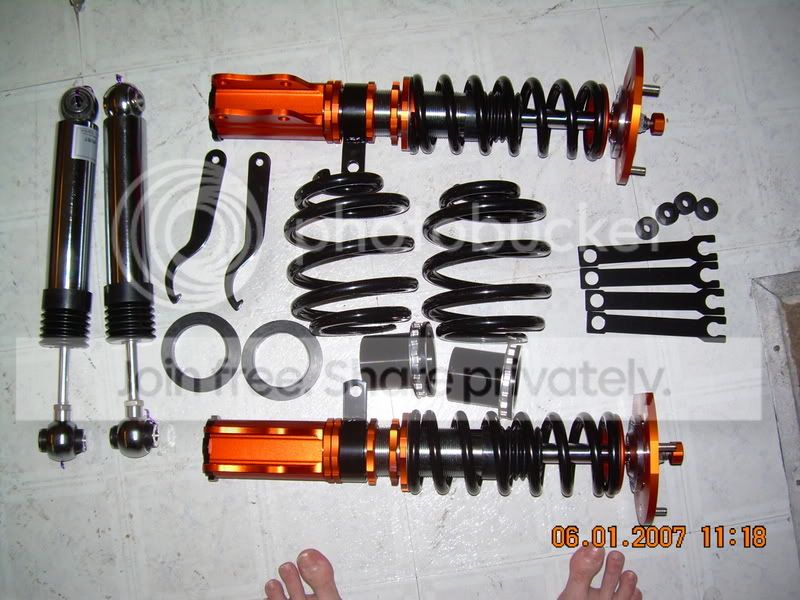

cant take credit
1 socket set
1 mallet or hammer
1 allen wrench set
2 jackstands
1 floor jack
1 factory jack(i'll explain later)
1 coilover set from k sport
i started with the rear since it's the eaasiest part of the job.

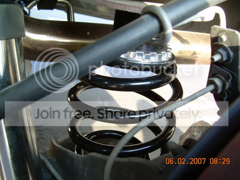

first put the car up on jack stands, then remove the rear tires. once thats done remove the strut bolts. i removed both sides at the same time. by doing so i dropped the whole rear swing arm.
once you have the old springs and struts off, put the new springs in first putting the adjustment sleave on top. then using your floor jack jack up one side of the swing arm till the struts line up with the bolt holes. make sure the springs and sleaves seat correctly!.

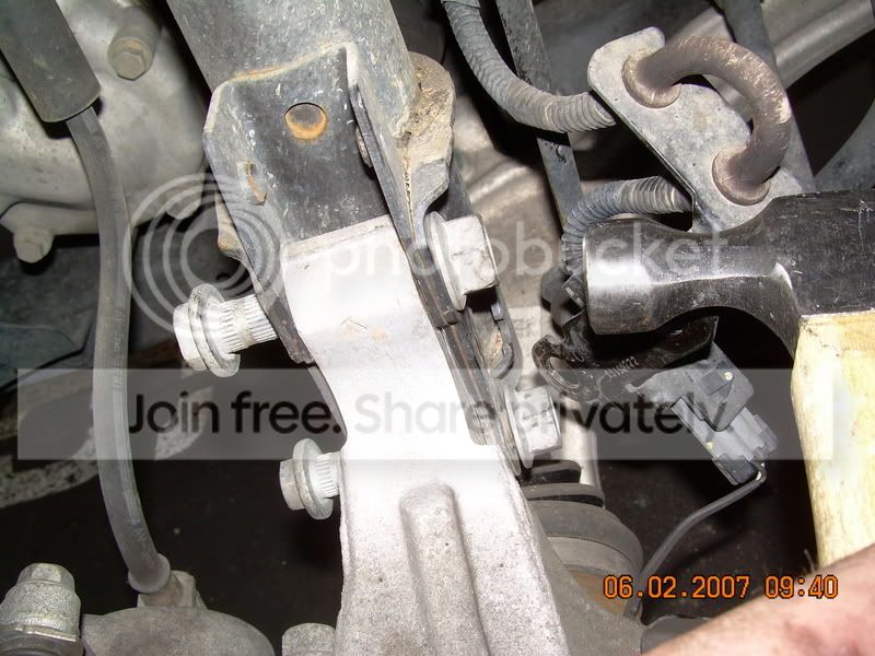

now with the front you want to start once again by putting the car up on jacks, and removing the tires and rims. next start by removing the two bolts that hold the lower strut to the a arm.
you may need a hammer or mallet to remove the bolt, i always leave the nuts on the end so i don't damage the threads(not a prefered method but it works)

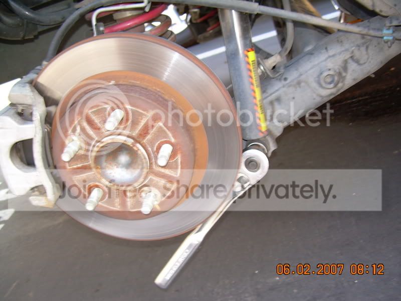

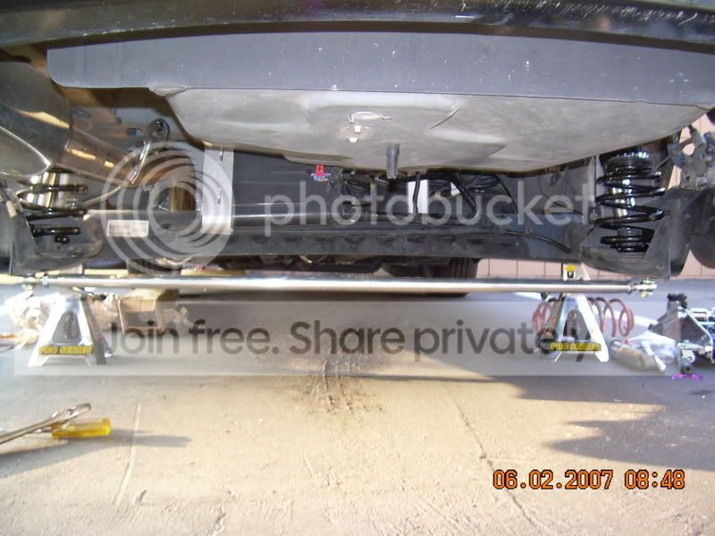

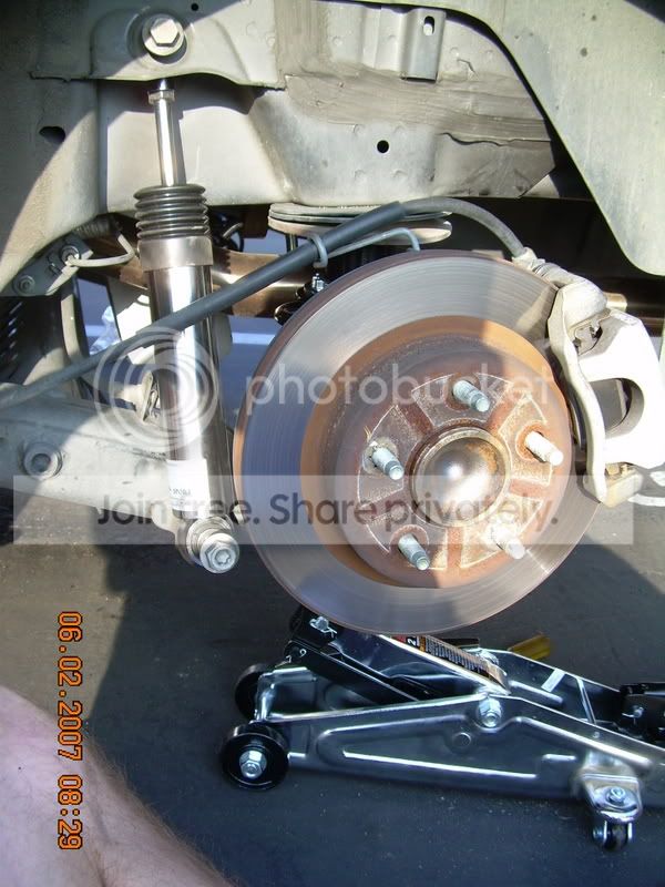

next just put the bolts into the struts
now go to the other side and do the same.
while i was at it i went ahead and installed my bwoody rear brace, just 2 quick bolts.

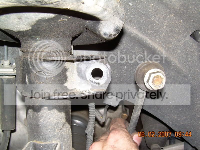

next remove the nut that attaches to the sway bar, i recommend removing both sides at the same time so the sway bar can hang freely.

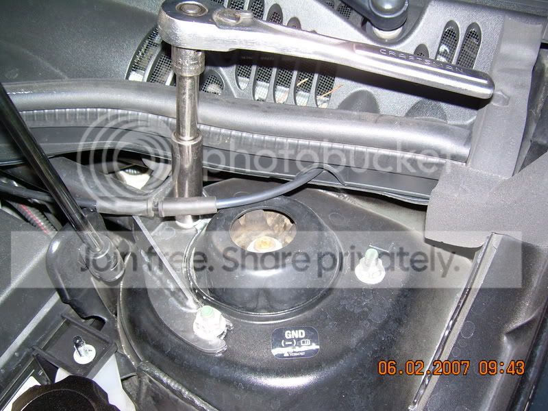

next remove the 3 top bolt bolding your struts in.

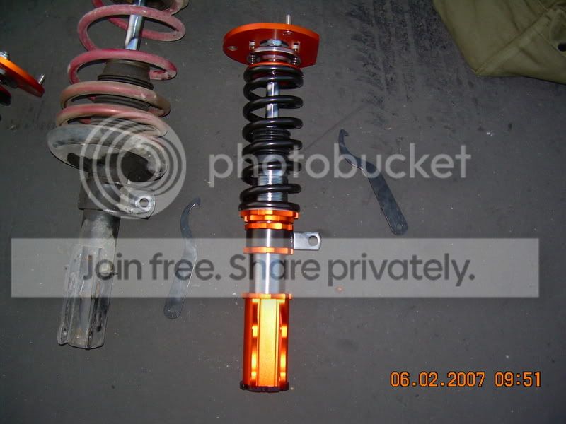

and ther you go now you have the old struts and springs out.***notice the blown struts-thank you Eibach***
now you wanna do the same to the other side.

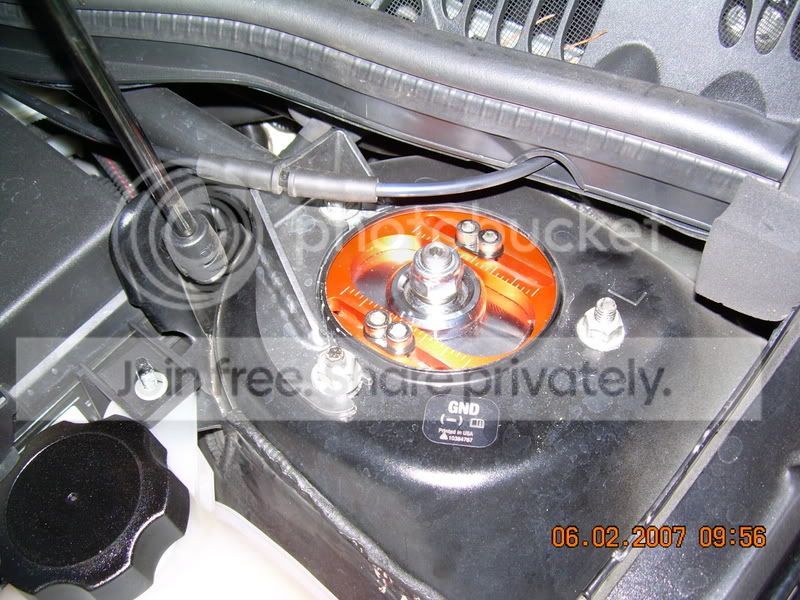

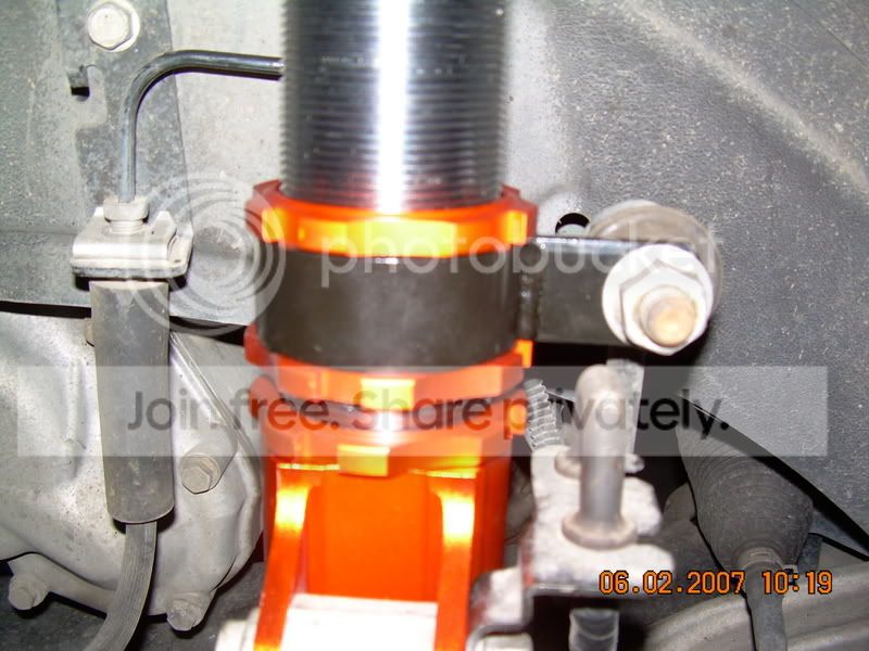

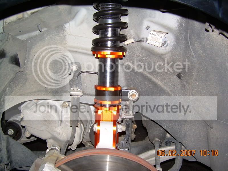

next you wanna adjust the coilovers to your ride height preference. make sure you adjust the sway bar link mount as high up as you can. and make sure both coilovers are adjusted exactly the same. next install the coilovers top 3 bolt first.
do both sides at the same time. next you wanna bolt up the sway bar links on both sides, make sure they have plenty of clearance from the brake lines.
next go ahead and put the lower mount strut bolts back in, it will be easier to do this using your jack to lift up the lower a arm.

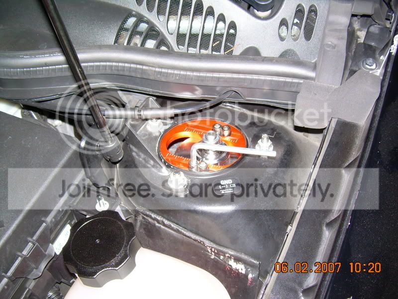

now adjust the camber to you specified setting.
