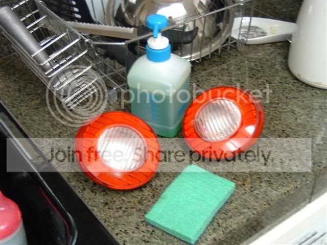

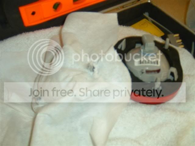

Step 1: Using the Soapy sponge scrub the lights clean. Wipe all traces of the soap off with a damp rag. Be sure not to get the electrical components wet.

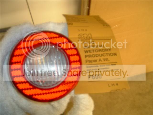

Step 2: Using the 600 grit sandpaper, evenly sand the light in the desired areas you wish to tint.
Step 3: Use the wet rag to wipe away any plastic debris removed during the sanding process.
Step 4: Tape off any areas on the lights you do not wish to be tinted. (Not applied to this specific tinting session) The use of a sharp razorblade works wonders when making precise cuts.

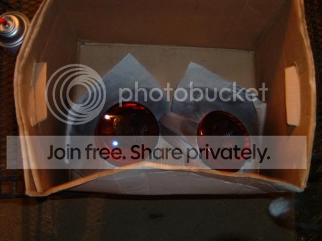

Step 5: Tape a paper towel or newspaper or whatever (or just jam it through the protruding plastic apparatuses such as I did) around the parts/pieces of the lights you do not wish to be painted (i.e. the back housing of the lights)
Step 6: Place the lights in an area you don’t give a shit about (large cardboard box or lying newspaper down works well if you don’t want to get paint on your floor/table)

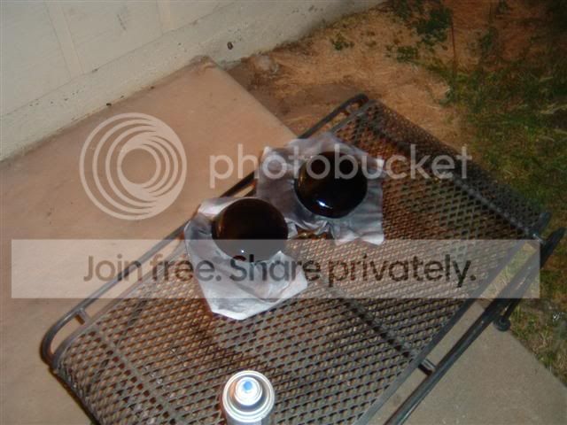

Step 7: Shake dat shit…. Shake your tint spray for about a good minute or so to make sure the spray is evenly mixed and not pasty. Once you are done making crude gestures with the can, you may now apply the tint.
Step 8: Hold the can UPRIGHT… approximately 12-15inches away from the lights and with a steady fanning motion apply a basic coat. Don’t go too thick on the coats. After you are done with your first coat, the lights should look something like this:

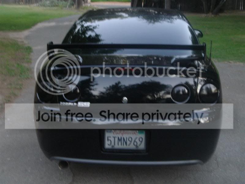

Step 10: after letting the final coat of nightshades dry for 30 minutes or so, apply clear coat in the same manner as the tint spray. I’d recommend a good 2-3 coats of clear coat. Let the lights dry for a few hours after the process is complete. You may now reinstall your lights!

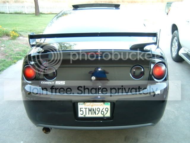

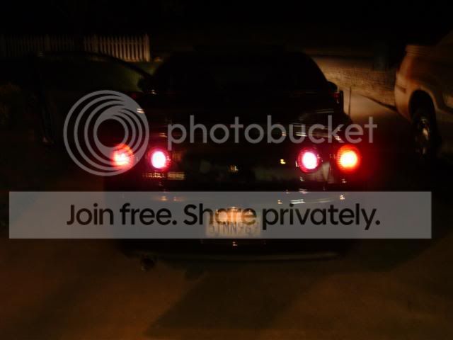

Brake lights during they day:

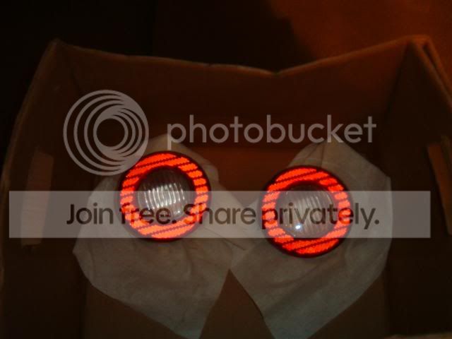

Brake lights and reverse lights at night:
The clearcoat allows you to wax the lights just as if they were part of the body and adds a nice shine.
