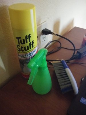

THINGS YOU WILL NEED:
can of Tuff Stuff multi purpose foam cleaner (about $4)
upholstery brush (medium to stiff bristles, I used a TIRE BRUSH in this case, about $3)
drying towels you don't care about (make sure your wife doesn't care either, ask me how I know)
some sort of water source (a garden hose or pressure washer would be great)
vacuum source (I used a small Shop Vac with a narrow crevice tool attachment)
time and patience (you may need to borrow from someone else if you have none)

So now that I know how filthy that carpet is, I want to clean it and my seats the same way. Of course, unless you take your whole interior apart, you can't put your seats and carpet in the bathtub to rinse off with the shower head. And I'm not doing that. But here's what I will be doing to take care of that in the next day or so:
Water source: cheap little dollar store spray bottle
Vacuum source: my Shop Vac
Drying source:: got a bunch of towels from a thrift store for 50 cents each (spent $3)
I'll run an extension cord out to the parking lot and have my Shop Vac there to "extract".
1) Vacuum carpet and pick out crap
2) Tuff Stuff, thick spray, brush it to death
3) light spray of Tuff Stuff, light brushing
4) light spray of plain tap water from bottle, light brushing
5) vacuum it to death
6) towels towels and more towels to dry it aas best I can
7) leave windows cracked and let the sun do the rest
8) be ready to clean windows and plastic surfaces the next day from the evaporate
I'll try to take more pictures, too.
You can spend $11 on stuff and borrow or have a Shop Vac and do this yourself, or you can pay a detailer $75-$150 to do it for you. Or you can buy a Little Green Machine and have your own extraction unit like a detailer but that's $80-$100 and I'd rather save that money for other things and use some free time to do it myself. But if you have pets you might want the Little Green Machine. You'll be shocked how much crud you can get out of your carpets and furniture in the home.
