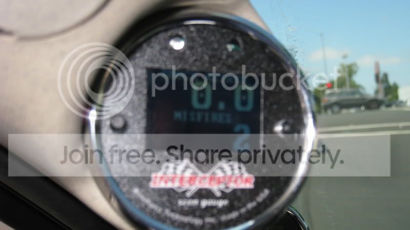

Anyways on my interceptor gauge it sometimes shows misfire like pictured below then goes back to 0. I got no CELs tho so should I be worried?

ya i've come to learn our cars misfire if you blip the throttle and if it doean't shift the way it likes it will as well. from what i can tell its normal

I get really small amounts of misfires as well. My DashHawk shows all 4 cylinders and get between 1-3 on different cylinders randomly, but it never does it two days in a row.

well if it starts massively misfiring then worry those little ones could be almost anything. mine does it as well

My old SS/SC used to misfire between shifts and when rev matching a down shift.... since it was new . It never set a code and was more of an annoyance than a problem . I bet that what your seeing , If it doesn't misfire under load than i wouldn't worry about it .
