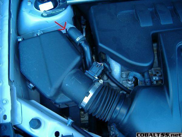

Since you don't have a location showing, I would like to mention this before you buy any intake related mods.
Some states (California mostly), starting sometime in 2006, got cars with a Secondary Air Injection system. If you have this, only 1 performance intake (K&N) is confirmed to fit & work properly, and I don't believe anybody made headers for Cobalts with the SAI. Everything else should be clear to go.
If you see that hose that the red arrow is pointing to, you have SAI. If there is nothing there underneath the sensor plug, you do not have SAI & can ignore this warning.

There is a delete for that some where...

I believe that also requires a tune to not throw the CEL. Plus, if the OP still lives in a place that requires it to pass emissions, he'd probably also fail that.
I love living in middle Georgia. The only place that requires emissions is Atlanta. And maybe Savannah.
He's got it, no biggie. I'd just get the K&N intake anyways. It's really the nicest one. My AEM was ok but for the money I wish I had bought the K&N.
